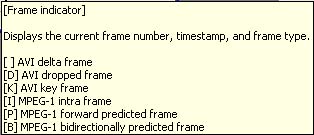

See this, taken from a VirtualDub pop up:

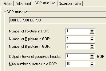

A GOP has a "structure" - a way of arranging the I-, P- and B-frames. The one I use for PAL in TMPGEnc is I : P : B = 1 : 4 : 2, as below:
This gives 15 pictures in a GOP, calculated as follows:
Rules: GOP starts with an I-frame. B-frames follow either the I-frame or a single P-frame. Only one P frame at a time.
So, you'll get 1 x I + 2 x B. No I-frames left coz you only specified 1, so next is 1 x P followed by 2 x B. And so on... So for every I- and P-frame there's 2 B-frames, making little clusters of 3 pictures (1 I- or P-frame plus 2 B-frames).
Formula works out as: (I + P) x (B + 1) = (1 + 4) x (2 + 1) = 15.
(The "+1" in the "B + 1" accounts for the preceeding I- or P-frame, and the (I + P) is the total number of little clusters).

1. Each GOP TMPGEnc Xpress 3.0 encodes for my NTSC project for both CBR and VBR are as follows:
IBBPBBPBBPBBPBBP, IBBPBBPBBPBBPBBP, ect. so I guess my NTSC GOP is set for 16 if you count the I frame.

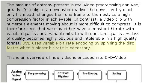

The speed the DVD spins will slow down progressively as it plays but in no case will bitrate have any effect on it.
http://electronics.howstuffworks.com/dvd12.htm
CBR actually does not mean constant bitrate, it means constant buffer rate. The bits per second still fluctuate per scene just not by as much so that the buffer size remains constant. -
Adam, this is what I was going on:
http://www.iis.ee.ic.ac.uk/~frank/surp99/report/kht97/work.html
