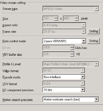

    How about the following as the encode settings - ( I modified the NTSC DVD template for VBR 2000 min 7000 ave 8000 max and 10 bit precision)

    RacerX - Well, we need some source file that will take more than 3 minutes to encode, otherwise the results aren't going to be very accurate. The original media I used for the first series of tests at the top of this thread was 400MB.
  13. contrarian rallynavvie's Avatar
    Minnesotan in Texas
    If you're going to do the mark then save your TMPGEnc settings file and post it so we all use the same encoder settings. Recommend a good VBR setting too and high motion search.
