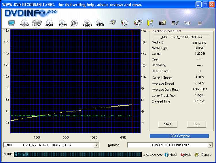

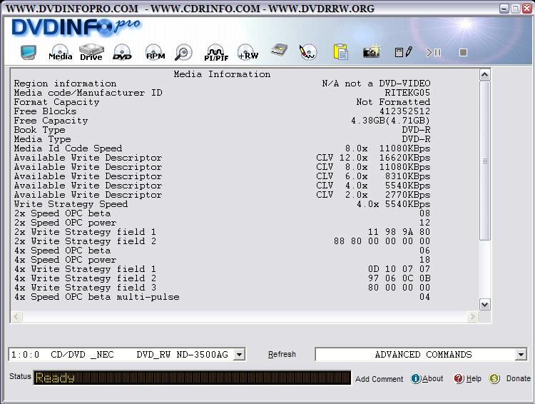

Ordered a 100 pack (came in two 50 packs, red wrapping, no spindle) from Supermediastore. Will be posting scans as they complete.
Will be burning on a NEC3500AG, V2, Revision 2, of Liggy & Dee's Firmware.

This first set of scans are all burned at 8x. I will be posting 12x later.

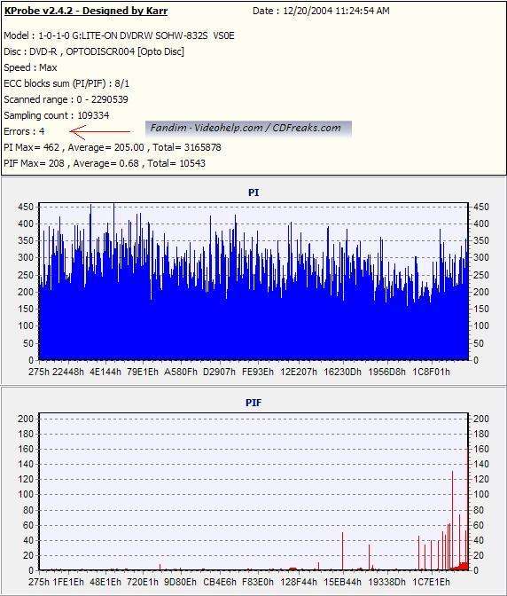

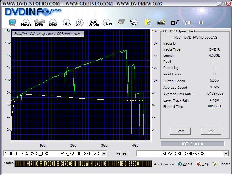

THE FOLLOWING SCANS ARE NOT G05!
OPTODISC -R!
(I scanned these at max, and 4x...and sadly - these 'max' scans, were better.)

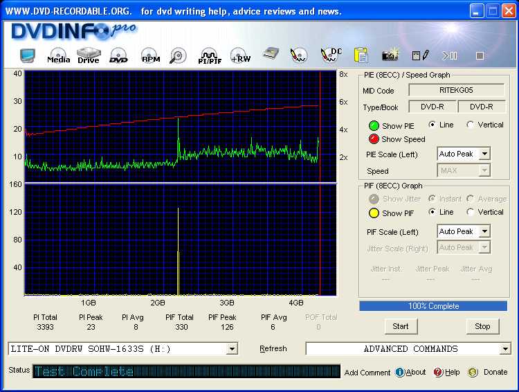

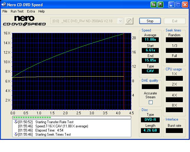

here are some scans from my NEC 3500AG, 2.18 hacked firmware, RITEK G05 White Inkjet Hub Printable--Are these scans any good????
It's acutally hard to tell due to that spike in your PIF's...cant really determine what all the other PIF's are at...You should remain below 4 PIF's..(Single spieks are usually dust, fingerprints etc, and arent normally something to worry about.) and 260ish PI's. I'd say that disc (LOOKS* okay...but hard to tell, once again, because the PIF's etc.. You should really get kProbe since you're using a Liteon already anyways.

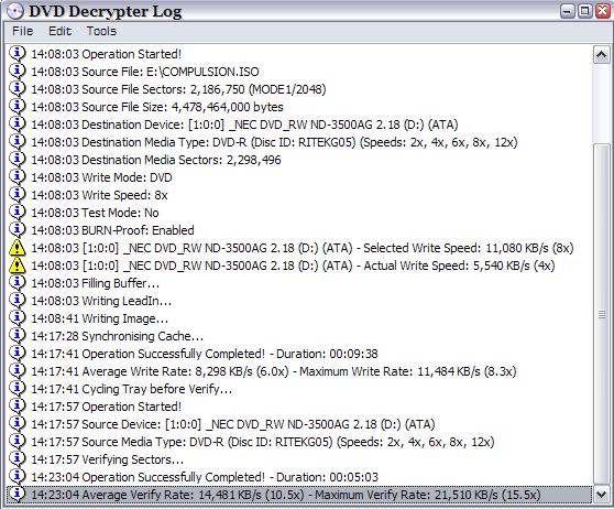

look again..
The wrting took 9min38seconds...
The Verification took only 5ish minutes..

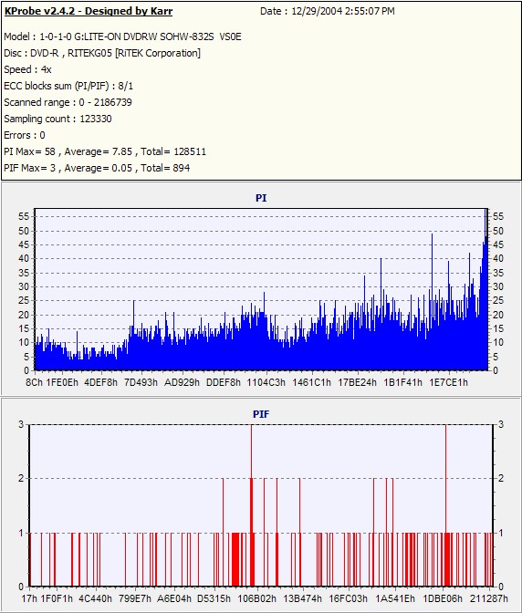

I've now had 3 coasters (that I know of - didnt pass verify), out of 50. Not bad...all seemed to fail at around 96-97%.

Hi. An update.
Going back scanning, checking them out etc..
And keeping verify checked after burning every burn....
Discs = Crap.
33% - 50% seem to be coasters. Total crap. I'd have to honestly say, some of, if not THE worst media I've tried. Just keeping everyone updated.
The ones that do burn have GREAT scans etc, and playback is great, too. But at only 50% success rate at 8x?
Pathetic.
