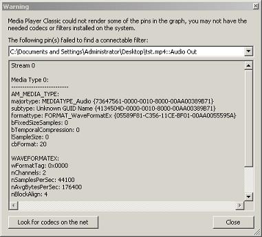

    I just encoded an HE-AAC stream then disabled both Nero Digital, and CoreAAC decoders. When i tried to play the stream this is what i got;

    You shouldn't need to disable anything, if MPC's internal filter is enabled then it will get used. The problem I would think is that the mp4 splitter/source can't connect to mpc's internal decoder. A different splitter may work, however in this case we are talking about an mkv file, which probably means mpc's own mpc splitter that can connect fine. Try running your he aac mp4 through mmg.

    Confirmed! It refuses to play inside a *MP4, but will inside *MKV (But it sounds awful!)......It must be overlooking the SBR bits. It sounds like playing mp3pro with a non-pro decoder. The audio was also 5.1 but now reports as stereo.
    Onboard AAC decoder doesn't like *.AAC file at all (using AAC-parser filter).
    Nero Digital filter doesn't get along with AAC-Parser filter (slow motion).
    3ivX Audio decoder doesn't (seem to) have a poblem with *.AAC w/ AAC-Parser. I did find the AAC-Parser filter link on the 3ivX page, its no wonder that it works correctly.
