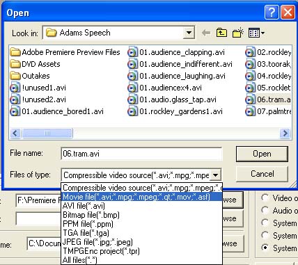

    According to the list of files TMPGEnc accepts when opening a source, it (TMPGEnc) will accept *.mov files and that'll convert them for you to MPEG1.
    And, for MPEG1, it's free!

    As for TMPGEnc doing *.mov or *.qt files:
    I've not done it personally, but this would suggest it's possible...
    You're not trying it this way are you?

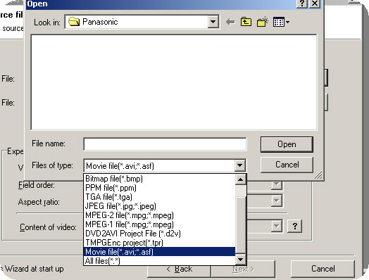

    I don't have the QT option, any bright ideas?

    I'm running version 2.52.34.129 You?

    Mine's 2.59 .47.155

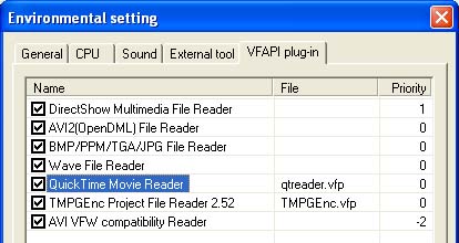

    https://www.videohelp.com/tmpgenc.htm#problems
    To convert from QuickTime MOV videos you must download the qtreader.vfp and copy it to the TMPGEnc folder.

    Also, if you get an error from TMPGEnc about a problem decoding the audio once you've pressed "Start" then go to Option -> Environmental Setting -> VFAPI Plugin (tab) and set the "Quicktime Movie Reader" to the top of the list by right-clicking on it and "Higher Priority" until it's at the top.
    My TMPGEnc hangs once it's done, but the MPG file is OK so I just kill TMPGEnc in Task Manager.
