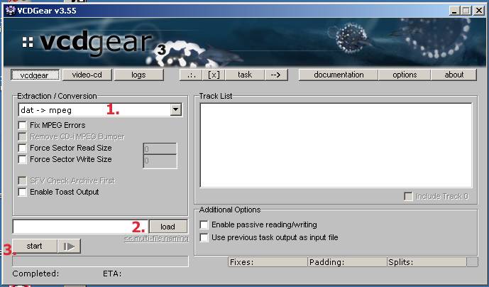

    All you need to do is:
    1. Set the conversion type to dat -> MPEG
    2. Browse to your drive with the VCD in it, go into the MPEGAV directory and select the AVSEQ01.dat file.
    3. Press the start button. You will be asked where you want to save the file to and what name you want it saved with.
    This will create an MPEG file for you. Then you can load the MPEG into goldwave directly, or load into virtualdub and extract to a WAV file using this guide.
