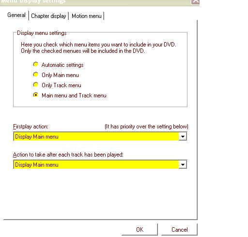

    I copied a VCR tape to my JVC DVR. Then I converted to mpg and saw I did not need to edit, as all I wanted was there. Now, I used TempGenc DVD Author 1.5 to burn. Before I burned, I made the chapters and a custom menu. Edited the menu to my taste and proceeded to burn.
    Everything came out fine, but I cannot get the chapters to play.
    I checked Display Main Menu and After First Track is played. Chapters do not play. How can I get the chapters to play?

    Aug 2002
    South Florida
    This should work, but it does not.
    1. Rip with DVD Decrypter
    2. make mpg with TDA to edit out junk
    3. Open mpg in TDA and create chapters
    4. Select custom menu and change fonts, sizes, etc.
    First Play Action: Display Main Menu
    Action after each track: Display Main Menu
    5. Output to TDA Video_ts file and burn
    If I select chapter first, it then plays the main movie, not the chapter.

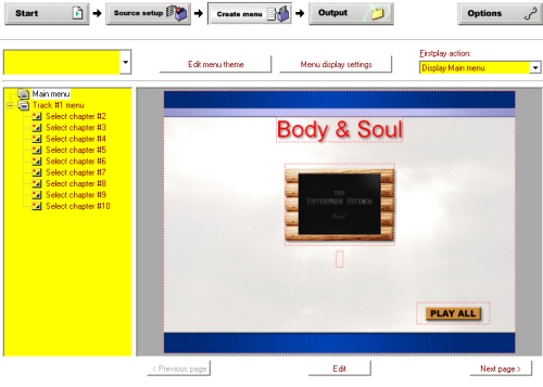

    Can you post screenshots of your menu settings ?
    Do you just have the one track, or multiple tracks ?

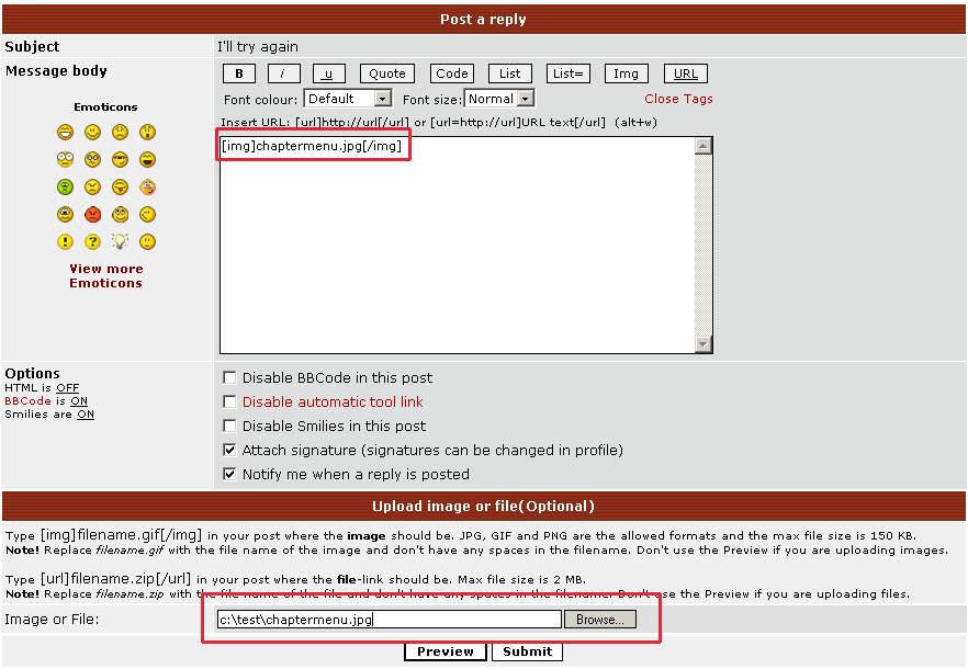

    Put this in the body text:
    [img*]filename.ext[/img*]
    (without the *'s)
    Then use the browse button near the submit button to browse to the file. It must be under 150K, be a JPG, PNG or GIF, and have no spaces in the filename.

    Do this:
    You can only do one image at a time, so do your first one, submit, then edit your post, do the second, submit, edit your post .... and so on.

    OK, so on the main menu, if you click on the play all button, it commences with the first chapter ?
    ... and if you click on the thumbnail picture, it takes you to the chapter 1 selection menu ?

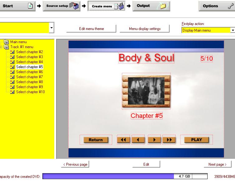

    When I click on the thumbnail it takes me to the first chapter. If I navigate to another chapter and hit the play button it does not play that chapter,but rather the main movie. That's the problem.
    In the main menu hitting the play button starts the main movie.
    What happens when you click on the thumbnail for the chapter you wish to play ?

    I never did that and just tried it---WOW!! It played the chapter. Now, I know I have to highlite the thumbnail of the desired chapter to get it to play.

    What happens is that the Play All button on the main menu plays all tracks - in this case, you only have one track so it just plays the entire feature from the beginning. On the track menu, the play button plays the entire track unless you select a specific chapter thumbnail.
