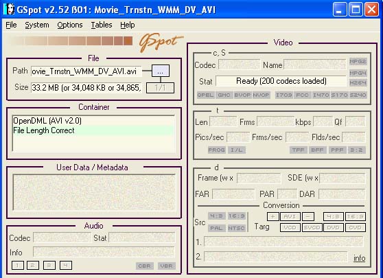

This one seems to be dragging on too long. What did you use to convert the WMM DV AVI type 1 file to type 2? I use DVDate which is a tiny little program that does a fine job for me. As a type 2, it should be bery easy to finish the job. What codec does the AVI file show (gspot)?
Maybe you should try DIKO or The Film machine to convert. TMPGenc is a bit more complicated but once you master it will give better results. -

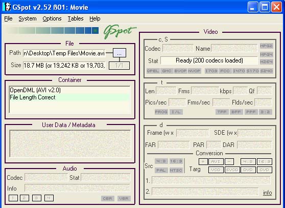

ok checked with gspot,
*once I have added the transitions gspot says this file is a non avi file of type unknown.
*I then checked the unedited file just after it had been imported into wmm ( ie just before I added transitions ) gspot says it is a multipart open dml avi.
Can anyone solve this?
I feel a bit stupid but as Ive said Iam a beginer and a lot of this is still very confusing yet.
Thanks again -

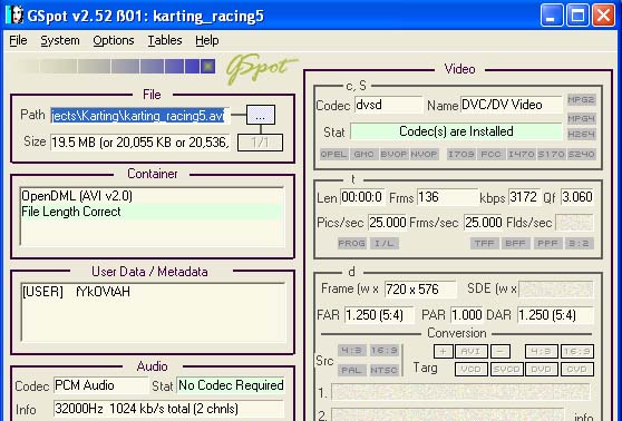

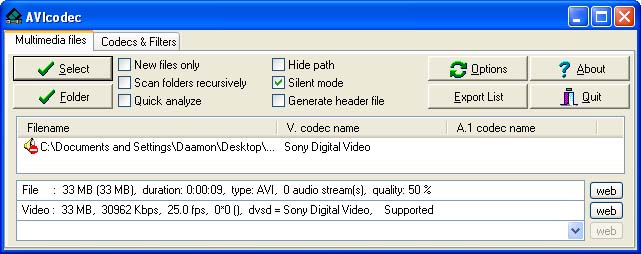

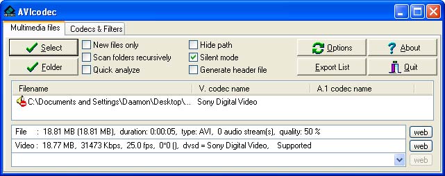

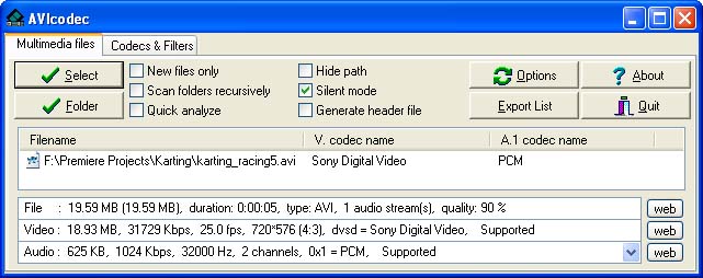

Hi dmcg501,
Here's what I've done as a trial, coz this is puzzling and shouldn't be happening.
1. Captured from my DV cam using WinDV to Type 2 DV AVI.
2. Used both AVICodec and the beta version of GSpot to get file details (note the 90% quality):
(Don't worry if your four letter code for the codec is different to "dvsd" - that means my DV AVI was shot by a Sony. Post yours, just in case...)
3. Loaded the original DV AVI file into Windows Movie Maker (v2.1.4026.0). Dragged the video onto the timeline and saved as a "DV-PAL" file.
4. Again, used both AVICodec and the beta version of GSpot to get file details (note the 50% quality):
5. Added a transition to the timeline and saved as a "DV-PAL" file.
6. Again, used both AVICodec and the beta version of GSpot to get file details (note, still the 50% quality):
7. In turn, loaded the original DV AVI clip, the WMM DV AVI clip (without transition) and the WMM DV AVI clip (with transition) into TMPGEnc.

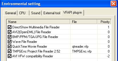

Each clip previewed OK and encoded OK. No errors, no problems. Here's my "Environment Settings" in TMPGEnc (v2.52.34.129):
Copy my TMPGEnc settings (don't worry about the "QuickTime Movie Reader" setting - shouldn't have an impact), and follow my steps to the letter and see how you get on.
As an aside: I'm not sure what the "Quality: 90% / 50%" is actually referring to, but I doubt a quality of 50% is a good thing compared to 90%. Maybe someone can enlighten me / us?There is some corner of a foreign field that is forever England: Telstra Stadium, Sydney, 22/11/2003.

EUREKA!!!
Thanks Daamon, Ive found whats wrong. i didnt know what AVIcodec or GSpot were till u suggested them.
I now understand where all the disk space goes on these movie files, as i went thro all the proccess with my clip I did not realised how many copy files were being made.
Not being sure of what I was doing i saved everything when prompted. When u finish putting transitions in in wmm it askes if u want to sav as wmm project. I said yes and saved it.
As i was going to convert in TMPGEnc Im trying to find the file with the transitions in it, logically to me i go for the one with the wmm icon on it with the appropriate file name.
The reason TEMPGEnc couldnt open it is because I was trying to open the wrong file ie a wmmproject file. Anyway got there now.
