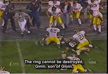

    Since I have no idea what you mean, I grabbed some .sub subtitles from an old project of mine (LOTR:FOTR), loaded them into SubReSynch, saved them as an .srt file, and used an old UM football clip I also had laying around. This what I came up with by loading the .srt file into Virtual Dub's TextSub filter:
