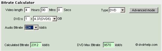

    The way that will definitely work involves using the VideoHelp.com Bitrate Calculator, and in this case we get the following:
    You can see in the above picture that I've set the running time at 4 hours, and our target is a 4.7GB DVDR. Assuming we use 224kbps audio (you can set this to any value you intend to use), the calculator tells us that in order to make 4 hours fit on 1 DVDR, we need to use a video bitrate of 2312kbps or less.
    So we plug these figures into our MPEG encoder, and when it's finished, we have DVD-compliant files that will fit on 1 DVDR. But, if you choose to go down this path, there's a HUUUUGE can of worms that will be opened, and a few decisions will need to be made.

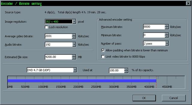

    If this can help, TMPGEnc XPress will do all your bitrate calculations for you automatically and even automatically lower your framesize, or "image resolution," as it calls it, to half D1 (352x480), as in my screenshot, or even VCD size, when you go below a certain bitrate threshold. Sure, it's not as good quality as 720x480 at a decent bitrate, but if your objective is to squeeze 4 hours on one DVD, this is a good and relatively easy way to do it. Just load your source files, choose a VBR DVD template when you Set Output, accept the default calculations and encode away. Sometimes, the quality of source files doesn't warrant full D1 DVD anyway.
    352x480 2.5 VBR
    However, I tend to agree with FulciLive 100% on this one.

  10. i'll try dvd rebuilder. I couldn't change the image resolution with tmpgenc. Only the bitrate. Also it doesn't allow dolby surround 5.1. Any other software where you can change the resolution?
