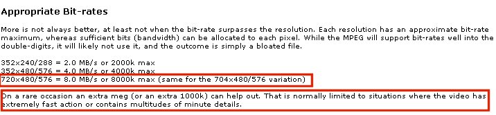

Well, i suggest you should read this page:
http://www.mediachance.com/dvdlab/tutorial/bitrate.html
It says there that in a certain point it's not necessary to increase the video bitrate because it wom't bring any more quality to the video..you need to analyse the graphic in that page and see what suites you more!..thoughts arrive like butterflies.. -

Well, the first thing I'll say is that AFAIK, the 9800 bitrate "limit" is only if you want the DVD playable on a settop DVD player, and as such, this is why a lot of authoring softwares complain about it. For archival purposes, you could go well in advance of this if standalone playback isn't required, since you're just storing it as a data file and not as a full-blown, authored, settop-playable DVD. From the two links I've just read though, it would seem that there's no need to go above about 9000kbps:
(I trust LS here

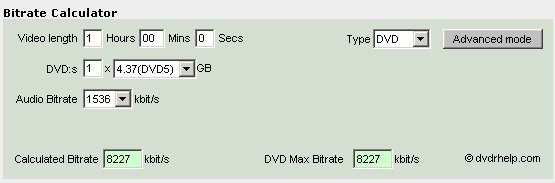

Now IMO, the main issue comes when we talk about audio. I would assume that since you're going to edit, we're looking at PCM ?
I did a rough calc of 1 hour of video w/ PCM audio and got this:
As for VBR vs CBR, it's a no-brainer IMO. As you can see from the images above, 1 hour of footage can be encoded at 8200kbps with PCM audio and *still* fit on 1 DVD. As vhelp said, any quality you cut due to VBR is gone and forgotten, and CBR 8200 should be suitable for just about any footage from the get-go. Then there's the time saving with CBR too.
So it would seem IMO that CBR 8200 w/ 1536 PCM, or CBR 9000 w/ 448 AC3/MP2 would be the two options that are the most efficient from a number of different perspectives.If in doubt, Google it. -
