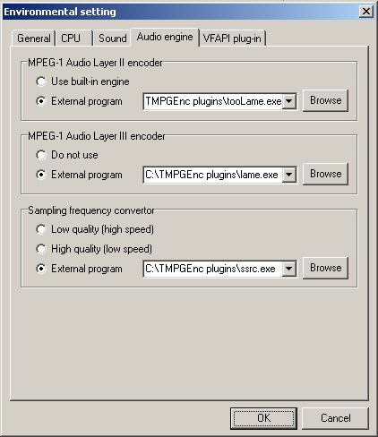

You might try re-encoding the audio to MP2 in ffmpeggui or besweet instead, just to see if it is TMPGEnc that is causing your synch problems. It used to be the case that TMPGEnc's audio engine was not too flash, and it was recommended that you reconfigure TMPGEnc to use Lame for MP3, toolame for MP2 and SSRC as the resampler (you can change this under Option > Environmental setting > Audio Engine):

Btw, Jim, I did as you said about the audio engine in TMPGenc. Thanks for the extra tip though so far nothing is helping...
