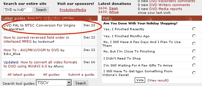

    Just curious when a guide posted here has something mentioned that will cause more problems such as the newly posted pal to ntsc guide where the writer says to use 29.97 fps instead of 23.976,whats wrong with this is its not mentioned that you have to check do not framerate conversion when using 23.976 fps so the conversion doesnt appear jerky plus choose 3:2 pulldown when playback encode mode.
    Im sure people will get jerky conversions with the method described.

    I did say newly posted pal to ntsc guide,if you had of simply checked the new guides here you would have seen it there.
    https://www.videohelp.com/guides.php?guideid=719#719
