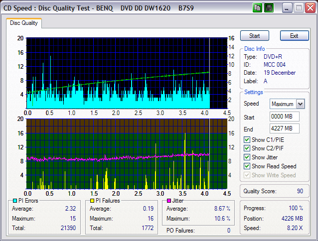

I ran the nero cd/dvd quality test and I had about 90% quality score on the burn I had made, it was an dvd+r 16X disc but the speed indicator near the bottom right on the test screen only showed that the "speed" was around 8X!! Am I missing something? The drive is a HP630i, flashed with the newest FW to a benq 1620 (dual layer).
those PI and PO errors are very low. I wouldn't worry about anything. As far as the speed goes, there's nothing wrong with that as it's a burned piece of media.
YOu might go to cdfreaks benq forum, I'm not sure 90% is that great of score for MCC 004. You might change to another firmware like P.
