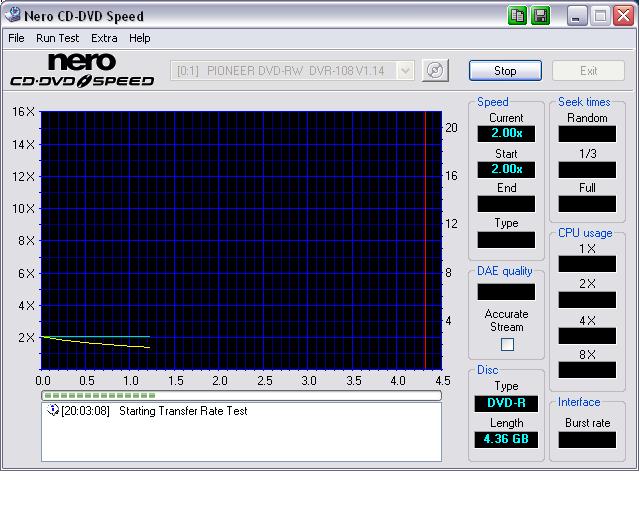

    check out this scan from one of these F01's. i had to stop in the middle as it was taking sooo long.

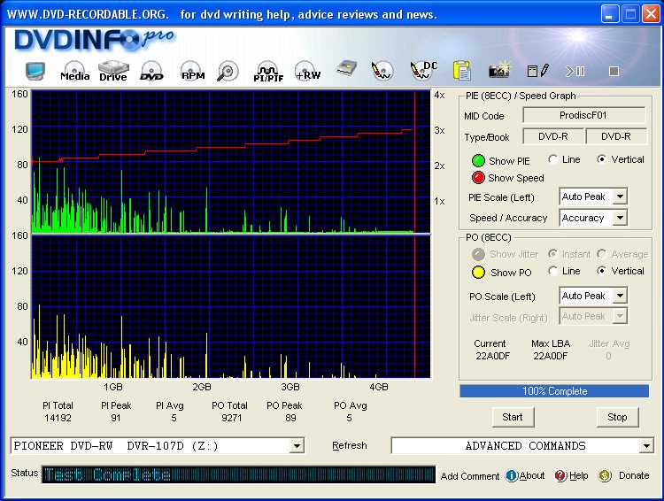

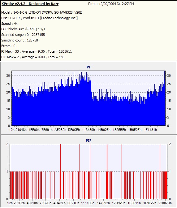

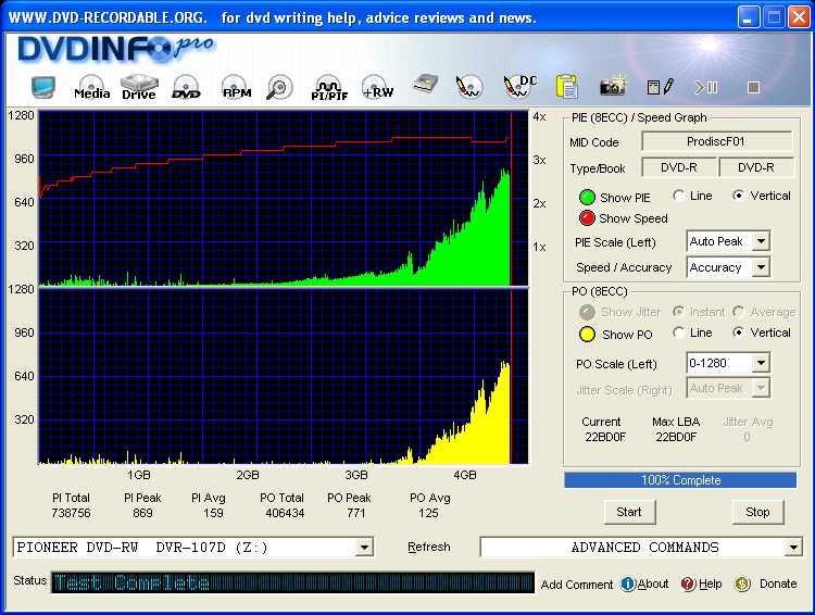

  18. I too am having terrible luck with the Prodisc F01 discs (inkjet printable). Never had any problems with the older media from Prodisc. Anyways it seems like the discs quality's completely random. I'm getting about 50% bad discs from the two different spindles. I'm using a Pioneer 107D drive, tried different firmware 1.18, 1.20, 121 made no difference. Nor did burning speed, have tried 1x, 2x, 4x, 6x, 8x all had good discs and bad discs. The only thing that's consistant is the error rate on the bad discs all increases dramatically starting at the 3GB mark. Here are scans from a good disc and a bad disc.
    Good Disc:
    Bad Disc:
    -LeeBear
    So far, it looks like the media code or dye is fine, but the INKJET version of the media has flaws. Probably wobble issues from imprecise balance.

  22. Yeah it looks like the problem seems to be with the printable discs. The bad discs have similar scans to discs with stick on labels from the sticky thread. Huge error rate increase near end of disc. Also there was another thread someone posted about the the printable surface coming off in the drive, so everything seems to point towards bad adhesive.
    -LeeBear
