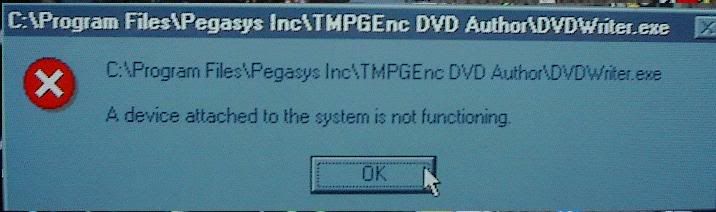

im messing around with TMPGEnc DVD author so i can get use to the program, before i get my dvd burner installed. i did everything in this walkthough http://www.digitalfaq.com/convert/vcdtodvd/vcdtodvd.htm but when i get to the DVDWriter progam it saids "A required .DLLfile, PSA.DLL, was not found" is this because i dont have my dvd burner installed? or is this a bigger problem?

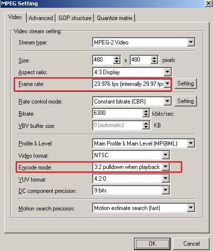

You need to use mpeg-2. 3:2 pulldown is not supported in mpeg-1, which is what the original VCD would be.Originally Posted by jimmalenko
On the Video settings tab, set Encode Mode as 3:2 pulldown, Framerate as 23.976 fps(internally 29.976fps).
DO NOT set the 3:2 pulldown checkbox on the advanced tab.
Actually, thinking about it, you could use mpeg-1, use the 3:2 pulldown option on the advanced tab and set frame rate to 29.976fps on the video tab. This would perform a hard pulldown and generate the extra frames for you. The other (mpeg-2) method simply adds flags to tell the DVD player to generate the extra frames (fields actually) and is preferable -
Good call - I missed that it was MPEG-1Originally Posted by bugster
dblue, if you're re-encoding now (it sounds like you're going to), the easiest way is to do what I said, but change your stream type to MPEG-2. In fact, I'd use the DVD (NTSC) template, because it will have all the right GOP settings, and all you'll need to do is change the settings we've discussed here, as well as the frame size.If in doubt, Google it. -
do u guys have any ideas about this problem?^^^^^^Originally Posted by dblue
None whatsoever. I've never heard of it, and a google search revealed nothing that was even remotely close to this. That said, it's nothing to do with not having your DVD burner installed, because you don't install any software when you do this, all you do is plug in the IDE cable and the power, and it is automatically picked up by windows.Originally Posted by dblueIf in doubt, Google it.

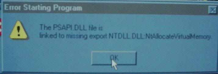

PSAPI.DLL ? You said PSA.DLL !
No wonder google didn't help.
Download it here:
http://www.dll-files.com/dllindex/dll-files.shtml?psapi
It probably needs to go in your windows\system or system32 directory.If in doubt, Google it. -
no it didntOriginally Posted by jimmalenko
heres what it saids now
then i hit ok and this is behide it
Well someone sure ate their carrots as a youngsterOriginally Posted by bugster
If he's going to re-encode to fix the 23.976fps and pulldown issue, then source being VCD is kinda irrelevant anyway, because he'll have to re-encodes to MPEG-2 to get the pulldown on.If in doubt, Google it. -
@dblue:
So remind me again why you're even trying to use the DVD Writer part even though you haven't got your burner installed yet ? There's probably something in the code that tries to detect your DVD burner, and if you don't have one isntalled, it craps out. So what I said before is probably not exactly true in that this error is probably caused by the lack of a DVD burner, but the file itself does not get installed when you install the DVD burner.
Of course I'm just speculating, because I've never tried to run the DVD Writer part on a computer without a DVD burner.If in doubt, Google it. -
here is the read me file that came with the psapi.DLL file . it tells me to "Use WinZip to extract the file to your windows\system directory" but i dont have a system directory foder? so were would it go? i have WINDOWS\SYSTEM32
WINDOWS\SYSTEM

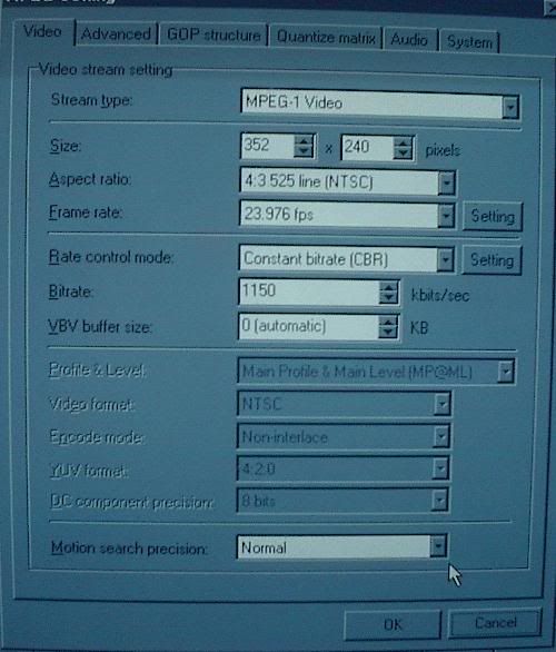

here is the default setting of the file im trying to get to dvd
It looks like you have loaded and SVCD template as your starting point. Make sure you load a NTSC-VCD template. Change the frame rate settings as instructed. As your source is VCD, it is 4:3 DAR, so leave the aspect ratio at that. Change the audio to 48khz to make it it DVD compliant (if you are encoding the audio in tmpgenc at the same time).
There is no real point in changing the resolution or bitrate from the original. -
Dude, how are you making your screenshots, like this?
Instead, hit the Print Screen key, for your whole screen, or better, Alt + Print Screen for a shot of just the active window. Then open up Paint or whatever image app you want, and select Edit | Paste. Save As .jpg. Oh, and it's appreciated if you resize your pics to no bigger than 640x480 before you post them. -
am i doing it right?Originally Posted by bugster
i loaded the SuperVideoCD (NTSCFilm).mcf Template
then i change audio to 48000
i set the source aspect ratio as 4:3 525 line (NTSC)
is this the right settings or did i miss something? -
