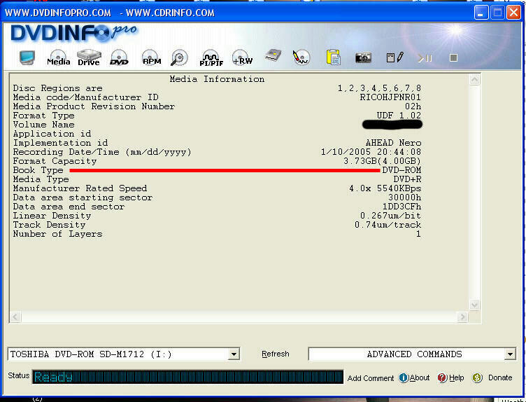

Have you looked at them through DvdinfoPro ??Originally Posted by RottenFoxBreath
And it say's they are DVD-ROM for booktype ??
