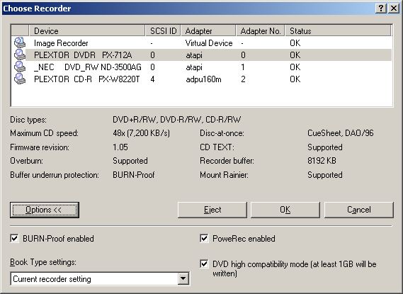

    I have included a pic of NERO 6.3.1.25 booktype option. Choose from the menu - Recorder -> Choose Recorder - and this window pops up.
    The drop box in the lower left corner allows you to set the booktype (when a drive supports changing the booktype) to DVD-ROM, +R, etc.

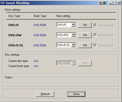

  13. Pop the disc in and check Disc Settings:

    In regards to Nero 6.6.0.x I have heard the setting was removed, I guess it is now in CD/DVD Speed.
    Some firmwares (The one I am using now for my NEC 3500A is Liggy's 2.18SE) automatically sets all +R discs to -ROM.
    To see what a disc is, you can use a program like DVD Infopro, or DVD Identifier link.
