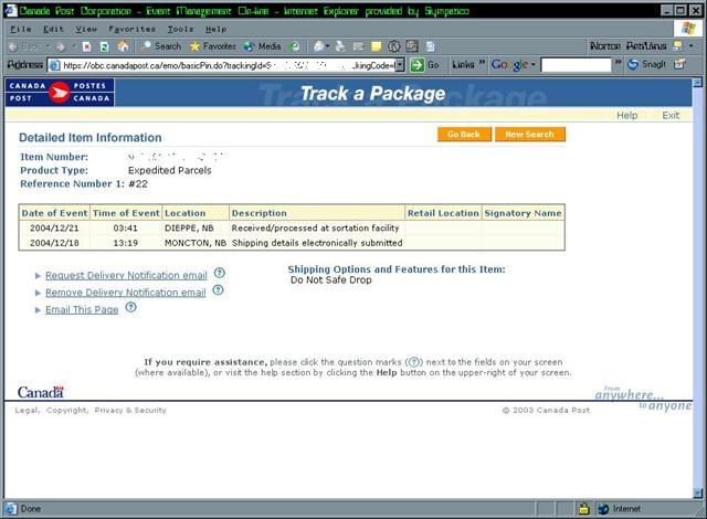

  23. Member p_l's Avatar
    Montreal, Canada
    Well, crap, crap, crap.
    I thought I was pretty smart for stocking up on Prodisc 4x Inkjet Hub printables, since problems have been reported with the 8x. The places I usually look (http://www.blankmedia.ca and http://blankdvdmedia.com/) had discontinued them, but like another poster here I found some at http://www.media-n-more.ca/. , thought I.
    I eagerly consult Canada Post's useless tracking system every day, which even after my doorbell rings and my packages are delivered, shows the parcels as still in Dieppe, New Brunswick, wherever the that is.
    But I digress. I open up the boxes, identify the discs, and it turns out they're S04's, so I'm SOL.

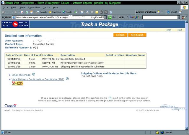

  24. Member p_l's Avatar
    Montreal, Canada
    Gee, thanks.
    This evening I finally get Canada Post tracking info that my parcel was delivered two days ago.
    Allow me to reiterate:
