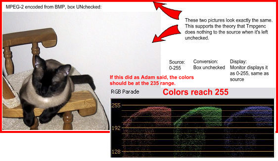

    Oh shit, I just realized that I completely contradicted myself on that last part of my statement with what I said in red next to Pic #2. Here's the explanation:
    Although Pic #2 is now a native 8-235, the monitor has rescaled it to 0-255. BJ_M did the histogram on the pictures after they hit the monitor. So technically the historgram is right because it's accounting for what the monitor did to the picture.
    Hey BJ! What's that program called that you're using?
    My contension all along was that leaving the box unchecked would produce a 8-235 scale, regardless of what type of source you feed it.

    the monitor does nothing to the histogram -- in fact, that system doesnt even have a monitor and i operate it with ultravnc ...
    a tv will not cancel out or change or de-core levels --
    ntsc is IRE7.5 and if 0-255 is used (which will look good on a pc monitor) , it will not look good on a tv ..
    NTSC is based on 75% color saturation and broadcast will allow ussually up to 121 IRE - and hard clip it ..
    a NTSC image will look 'grey' on a pc monitor ..
    in both cases - the tv and pc monitor are assumed to be properly set up -- one also is lin. gamma and the other not -- and the color temps are usually different .
    judging an image on a pc that will be shown on a ntsc monitor is pretty well a waste of time unless you use a scope (even then - with editing - you should view on true ntsc monitor ) ..
    I used Sony Vegas for the scope pictures ...
  3. If the "output YUV as basic YCbCr..." is unchecked, TMPGenc will compress the colorspace by 16. If you are using 0-255 and outputing to NTSC video, this is fine - you will then have 16-235.
    However, if you capture, for example, analog video at 16-235, and produce mpeg in TMPGenc (or other encoder) and leave the "output YUV as basic YCbCr" box unchecked, the video will be further compressed to approx 32-220 - not good.
    An additional problem is that some, most, my, NTSC DVD players add 7.5 IRE setup. So, if you began with 16, did not check the "output YUV as basic YCbCr..." in TMPGenc and make a DVD and play it in a NTSC DVD player, you could end up with black level at approx 48- where are my blacks.

    adam's theories notwithstanding, as far as I can determine and in every test I've tried, the YCbCr option in TMPGEnc behaves just like a luma levels filter set for input values of 8-235 and output of 0-255. Uncheck it, it always does nothing. Check it, and it always behaves the same as the levels filter in VirtualDub set to those numbers.
    Reward: First person that posts or PMs me a reproducible example that does NOT behave this way, I will Paypal you $5 so you can buy yourself a beverage. I think my money is safe ...
    Here's my operating theory. If TMPGEnc thinks in RGB, it always operates correctly when converting from YUV input to RGB internally, so checking the box is not needed and in fact checking it will always ruin (proper) YUV input. This option is merely to correct RGB input from codecs/capture drivers that produce a compressed RGB range instead of the full range it expects ... and in that case you're better off to feed it YUV if you can so you can leave it unchecked (just like CCE, surprise).

    With CCE in quick tests, on YUV input the 16-235/0-255 option has no effect either way as FulciLives said. With RGB input, 16-235 leaves it unchanged, 0-255 acts like TMPGEnc's checkbox, again correcting for compressed range in the RGB values.
  7. Uncheck it, it always does nothing. Check it, and it always behaves the same as the levels filter in VirtualDub set to those numbers
    Unchecked, the colorspace is compressed, by a value of 16. It may be difficult to see this effect, depending upon one's equipment. Using NTSC colorbars and viewing these color bars, before and after, using Photoshop, waveform monitors in programs such as Vegas video, and with hardware waveform monitors, this effect is readily apparent - 0-255 becomes 16-235 (good), 16-235 becomes approx 32-220 (not so good).

  10. Member adam's Avatar
    Sep 2000
    No, the reason it is the same is because he has posted a bmp still decoded from the mpeg file. When it was decoded the luminence levels were expanded to 0-255 during the conversion to RGB. I can tell that this is what you meant when you said it was adjusted for the monitor, and this is going to happen most of the time. Yes the result is the same because TMPGenc remapped the luminence levels (compressed) before converting to mpeg. Therefore we can reverse this when we decode it for pc playback. This is the correct way to handle 0-255 footage.
    Your luminence levels get compressed to 16-235 when you convert to mpeg...to be sure. That is all YUV supports. So if we then look at a .bmp still taken from that mpeg, and it shows 0-255 luma values, naturally its luminence levels were expanded during decoding. So it cannot be said that leaving the option unchecked did nothing simply because we wind up where we started. You've got to take into consideration the decoding that we are using to preview.
    Again, mpeg uses YUV and YUV only supports 8,16-235. When you convert to mpeg it is being compressed to 16-235 whether you know it or not. The only question is how you get there. With a 0-255 source there are two options. You can either hard clip everything below 16 and above 235 or you can remap 0 to 16, and 255 to 235, (aka compress) and then chop off everything above and below...which is now nothing.
    Looking at the pic you referenced compared to the one above it, the fact that they are the same is evidence that TMPGenc DID compress the luminence levels. If it hadn't then the outer levels would have been hard clipped and then once decoded to 0-255 on the pc it would have looked different.

  11. Member adam's Avatar
    Sep 2000
    This is the same as how I described above in your TMPGenc example. Your source is 0-255. When you choose 16-235 it remaps before converting. Nothing is lost. Now when you decode back to RGB it is expanded to 0-255 again and it looks identical to your source. It is not that "nothing" has changed, its that everything was preserved and thus looks the same at playback.
    By selecting the 0-255 option you did not remap your values. You hard clipped everything outside of 16-235 and that's why it looks "greyer" even after being decoded to 0-255 again. Those outer levels were completely discarded.

  27. Serene Savage Shadowmistress's Avatar
    Mar 2004
    Controlled Chaos
    First of all, @Adam: speak english!....no wait, speak noob!
    Since you agreed with me on what to do above - my consensus points #2 & #3, (you disagree with how it works but you agree with what to do) I guess point #1 is all that we disagree on.
    You said wash, rinse, repeat... so I did. After all, I was curious.
    I took 20 frames of a commercial which came in an avi format. (No, I don't know what the original RGB/YUV value is). I put it into tmpgenc, kept the same size and framerate and default settings, and coded all at CBR 7000 kbps. I made a file labelled one, then loaded one into tmpgenc and made file labelled two, loaded two in and made file three... etc. I washed it 20 times.
    The results were unexpected.
    Here is what happend when I always left the box unchecked.
    So then I thought, ok I should be compensating and coded every other clip with the box checked. This theoretically should preserve it to as close to the original. This is what happened.
    Then I thought, this can't be right, what happens if I leave the box checked through all the washes? And I got this.
    Is there a better preservation technique that I'm missing here? Could it be that it's just signal degredation from being washed 20 times? If you got a hold of the 20th encode of a film, which of these 3 would you prefer it be?
    In my opinion, always leaving the box unchecked does the least damage to the scale.
