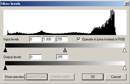

To find out if you need to tick the option, open Settings, go to the Advanced tab, and double-click Custom Color Correction. Tick "Show Histgram" (sic) and a "Histgram" window will appear. At the bottom, select YCbCr. If your histogram looks like this (no gap at the left side), you do NOT need the "Output YUV ..." option enabled:
But if your histogram looks like this (obvious gap at the left side), you do need the option enabled:

To see a histogram, load your clip into VirtualDub, go into Filters, add a Levels filter, hit Show Preview, and then Sample Video. A luminance compressed image will have no black bars at either end, like below:
I really think the only time you need to CHECK the box is when you have an input clip that looks like this in Virtual dub to start with. A properly encoded MPEG-2, which is CCIR601, fills the histogram when looking at it this way. -
