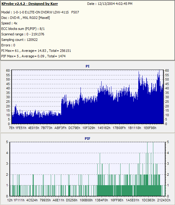

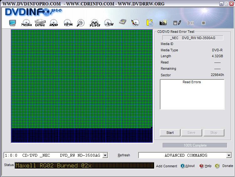

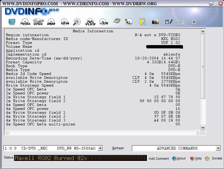

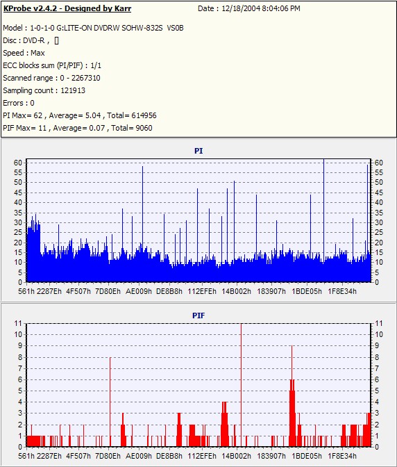

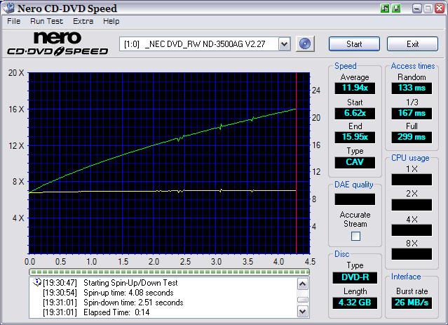

4x media. Batch I'm using is from Office Depot, Yellow topped, made in japan.
These scans are of a disc burned at 2x, using a NEC 3500.
Using NEC3500 for CDSpeed, DVDInfo Pro, and a Liteon 832 for KProbe.
Seth

Odd, I seem to be getting almost better KProbe scans from the same MXL RG02 (yellow top Maxell) discs when I burn them at 12x in my 3500
The stock firmware sucks for overspeeding these discs, even though they can handle such speeds easily - the forums at CDFreaks.com have modified firmwares that will give faster speeds if you wish (the Quikee2 version, actually, Liggy/Dee's only goes 4x max, same as the stock firmware).
What firmware on the Nec3500? I havnt updated in quite awhile..I dont even have the option to burn at anything but 4x..? And I think it has a chance of being my 832S..It dosnt seem to like -R media very well..
