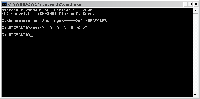

First you have to make visible all the files in Recycle Bin:
On NTFS disks
cd \RECYCLER
attrib -R -A -S -H /S /D
On FAT32 disks
cd \Recycled
As soon the corrupted file was visible I got a message from windows:
Found corrupt files in Recycled Bin
please run chkdsk, so I did
chkdsk /F /R /X
I emptied Recycled bin again, and voila empty.

What that guide you found was telling you to do was:
1 - Go to Start --> Run...
2 - Type in "cmd" and press Enter
3 - Type the commands in:
(it will look like that when you are done)
4 - It should tell you that it has found corrupt files. Go back to "cmd" and type in "chkdsk /F /R /X". If it asks if you want to schedule a checkdisk, press "Y" and restart.
If that person was correct, you will rid your system of corrupt files.
