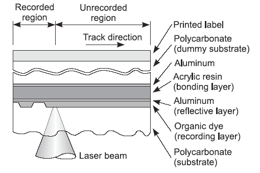

  5. "There is no "silver coating" on a DVD-R. The foil and dye is sandwiched between a plastic upper and plastic lower. What you claim happened is physically impossible. "
    Like hell I hav SEVERAL where the silver layer is RIGHT underneath the labeling and I HAVE PEELED them
    that is why I test all media with a screw driver I put a nice gouge into the top of the disc. if I see nothing on the other side I buy lots of it
    Chris Taylor
    http://www.zodiacreview.com/
    Believe what you want, but the facts are not on your side. There IS a plastic upper layer. A screw driver probably went through both layers. There is no "label" on the media, maybe a silkscreen or other thermal/inkjet layer on the plastic.
  7. Member Skith's Avatar
    Bottom of the ocean
    Straight from the horses mouth:
    http://www.dvdrw.com/information/white-papers.htm
    Look at the PDF "DVD+R - A Write Once System for video and data applications" on the above site, you will see this diagram:
    Some links to the DVD-R Forum:
    http://www.dvdforum.org/forum.shtml
    http://www.dvdforum.org/gen-discbond.htm

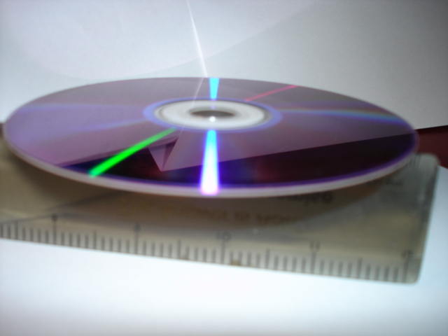

  12. Simple experiment to predict "data disappearing" for a certain DVD-R disk:
    I just made an experiment, that is easy to replicate. You just need a ruler, a hair dryer, and less then 1 minute of time.
    1) Take a DVD-R, that is suspicious for future "data disappearing", for example Princo.
    2) Check the top side with a ruler, whether it's flat.
    3) Heat up the bottom side of the disk. Use a hair dryer (about 1800 W) for 10 to 15 seconds, from a distance of 1 inch.
    4) Check again the top side with a ruler, whether it's still flat or significantly warped.
    5) If the disk is flat before AND after heating up, then "data disappearing" will not happen, else it can happen.
    The heating simulates the higher temperature in a DVD player.
    I carried out this experiment with several disks.
    The following disks were flat before, but warped by 1mm immediately after heating up:
    - Princo (white top, not printable),
    - LONGTEN001 (white top, printable)*,
    - A disk with paper label applied*.
    The following disks were flat before and after heating up:
    - RiData (white top printable),
    - Philips (silver-top).
    * Those disks are no longer playable on the outer side in a Pioneer DV-454, but were completely playable shortly after burning, 1 year ago. The others have no playability problem. I think the Princo may have problems in other players (There are many reports about bad Princo disks).
    The three disks, that showed warping after heating up, have all one thing in common: They have an extra white layer on top, that might expand/shrink differently with temperature changes than the rest of the disk, and thereby warping the disk.
    Experience shows, that "data disappearing" is a PROVEN FACT.
    I agree with Lordsmurf, that the problem is not the DYE. I conclude from the experiment, that the problem is WARPING. The disk is either already warped (production error) or warps itself, caused by temperature changes and under influence of humidity. Warping may lead to focussing problems in the laser optics.

  17. I think the heat in the experiment, I described above, will not kill the disk, because I limited the heating up to 10 - 15 seconds only. So the disk gets warm, but not really very hot.
    With this experiment I observe a difference between good and bad media. With the high temperature I wanted to warp the disk so much (1mm), that I can easily see the warping with help of a ruler. I think fosussing problems may already occur with much lesser warping.
    A blow dryer gets SUPER HOT in a matter of seconds. In fact, you can often burn skin or scorch hair. Hair dryers are really bad to use. Even for hair.
  19. Try it out yourself with a hair dryer and a DVD-R. If you touch the DVD-R immediately after that 10 to 15 seconds, you will observe that it is warm but not super hot.
    While heating up I move the dryer slowly a little bit, so that not all heat is concentrated only on one point of the disk. The whole bottom area of the disk should heat up uniformly.

  21. Originally Posted by lordsmurf
    I think the discussion can be made more productive, if vague expressions like warm, hot, super hot... are replaced by a temperature value. Therefore I just repeated one experiment in a modified way:
    1) I used again the white printable LONGTEN001 DVD-R as before.
    2) I checked the top side with a ruler, it was flat.
    3) I heated up the bottom side of the disk, until the temperature was 40C (=104 F) by using a hair dryer.
    I verified the temperature of the disk with an infrared clinical thermometer.
    I think in a normal DVD player such a temperature can be reached easily.
    4) I checked again the top side with a ruler, it was now warped by about 0.5 mm. That leads to an AVERAGE tilt angle of about 0.5. The tilt angle on the outer side of the warped disk is then much bigger than this average value and much bigger than the maximum tilt value of 0.8/2, allowed by the DVD specification (see below).

    Measuring warping: Lay the disk upside down on a ruler. The sides of the disk touch the ruler, the middle of the disk not. Look at the gap between the middle of the disk and the ruler.

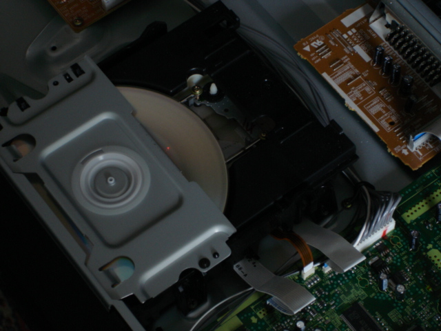

  24. I opened my Pioneer DV-454 for further investigation. I could not measure the temperatures in the DVD drive because I don't have an adequate thermometer. If I touch parts in the drive, they seem to be not very hot, including the top side of the disk. Perhaps only a few degrees above room temperature, if the chassis is open. What I still don't know is, how much warping of the disk is required to cause playback problems.
    I saw another interesting effect: At the silver-top Philips DVD-R, the laser beam was shining bright through the disk (see photo below).
    Could it be, that a white top labelling layer would reflect the laser beam strong enough to cause interference with playback?
    Caution: I advise others not to repeat this experiment, to avoid exposure to a laser beam.
