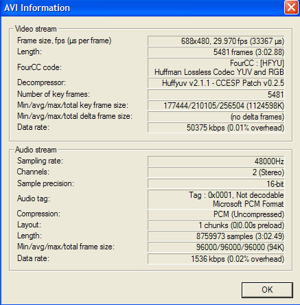

    I just did a capture using VirtualVCR
    I used HuffyUV and a size of 688x480 (proper aspect ratio for my BT capture card). I also used 16-bit 48k Stereo audio.
    This capture was just a couple seconds or so over 3 minutes and ended up with a file size of 1.10GB
    Anyways the whole point of doing this for me was to open the AVI capture in VirtualDubMod to illustrate that it shows HuffyUV for the codec:
    I am guessing you should be seeing something similar.
    - John "FulciLives" Coleman

  12. 688x480 at 30 frames per second in YUY2 format (what HuffYUV is compressing) is about 1.2 GB per minute. So if you're seeing 2 or 3 GB for a 3 or 4 minute video you are getting the ~2:1 compression you would expect from HuffYUV.
    688 * 480 * 2 bytes per pixel * 30 frames per second * 60 seconds per minute = 1,188,864,000 bytes per minute.
    My HuffyUV clip (688x480 29.970fps with 48k 16-bit Stereo PCM wav audio) was about 3min 3sec and it ended up being only 1.10GB in size.
    However it was a very clean source (commercial DVD via my DVD player) and the image was 4:3 WS (2.35:1 aspect ratio) so with that much black on screen (about 40 percent) I guess I would get better than normal compression?
    So I guess my question is this ... is mine on the low end vs normal? What about dazco's results? ... on the high end vs normal?
    Are either of us near normal?

    Yes, with 40 percent of the image black, and a nice clean signal like a DVD, you expect HuffYUV to get better compression. A VHS capture has lots of random noise and gets much less comression. I've seen anywhere from about 5:1 to 1:1.
