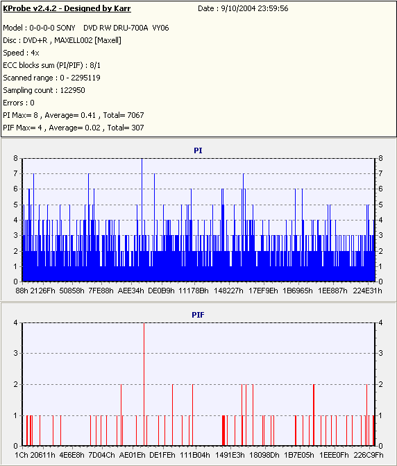

  4. Member Fandim's Avatar
    Jun 2004
    Reno, NV
    Scans from my wife's burn on her NEC2500 at 8x. Here's the Kprobe from it.
    Damn these things are smooth.

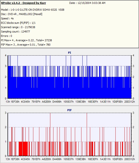

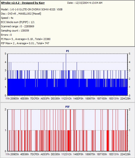

  19. Member Fandim's Avatar
    Jun 2004
    Reno, NV
    I got some of the Maxell RG02's (2x, 4x), and burned at 4x, I get some high spikes (like a 208 PIF, single spike, maybe a couple others at aroudn 60ish), and PI spikes very similar, as well. But I think it just might be the liteon 832, as all DVD-R media seems to do this, except TY media..It plays back flawlessly though, and backs up with no errors, as well.
    In general, I really have no preference as to + or - R, as long as it's high quality stuff...main reason I get TY +R's, is the firmware I'm using with the NEC 3500, lets me burn these at 16x, and i've never had a single problem with one yet.. (My firmware only lets me burn the -R Yuden's at 12x)..not really a big difference in time, honestly, though.
    I know smurf is very -R only... I'm just very high-quality only..couldnt care less about the -+R war.

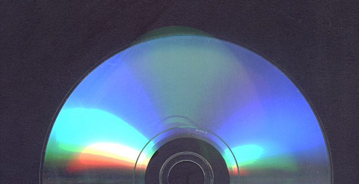

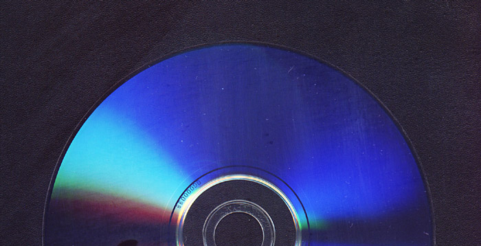

  29. Master of Time & Space Capmaster's Avatar
    Feb 2004
    Denver, CO United States
    Originally Posted by Gen-An
    Hrm, I could have sworn I was able to see the TY serial on the 25 packs. I know one way to tell MXL from TY is to look at the center of the disc; TY discs have a dark ring around the center while the Maxells don't. It's kind of hard to explain without pictures.
    I've got some TYG02. Lemme see if I can get a good scan or two and post it here
    Edit: I used a POS Visioneer flatbed scanner, and it has always had reflection problems scanning shiny silver things, but here are the TYG02 scans:
    Data side:
    Top side:
