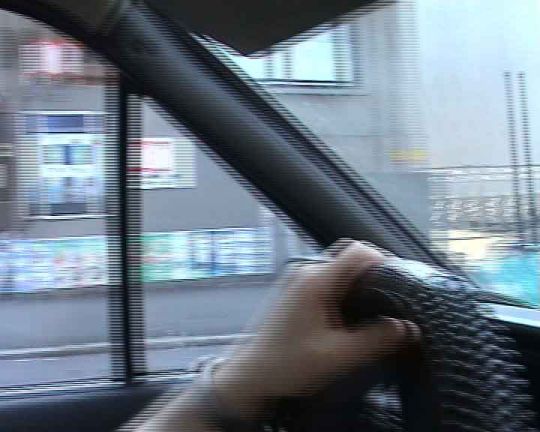

    The thing is, I usually capture episodes that I like on my satelitte receiver, (stored in .ts (sort of mpeg2)) but when I tried to encode it to divx I got this result.
    Look at the bad result, you can see horizontal lines everywhere.
    I know the source should be "perfect" since its capped from a digital broadcast. Hope anyone could help me.

    I'd say it's just interlacing - totally normal.

    Anyways, these lines are in the whole movie now and than. Arent there a way to get rid of them?
    Read this:
    http://www.digitalfaq.com/capture/interlace.htm
    INTERLACE is good. Do not remove it unless required. DIVX is supposed to use interlace, and playback progressive when on computer (as far as I know).

    Originally Posted by Eple
    Sorry, was thinking about the "upload file" feature.
    Sure. Deinterlace

    Interlacing:

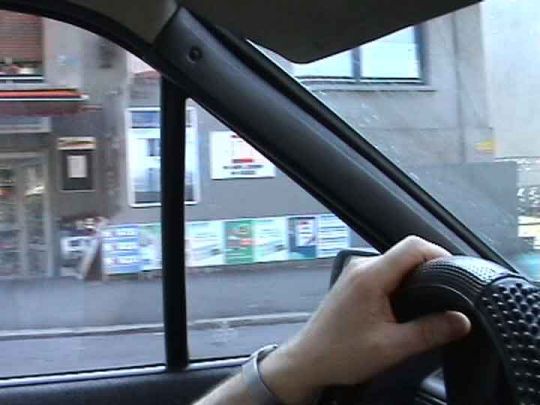

    after deinterlacing:
    Probably the easiest (and the best IMO) way to get rid of them is to play them in a player that deinterlaces properly (such as PowerDVD or WinDVD). Windows Media Player will not play them correctly

    EDIT: updated interlacing pics
    Does this look like the problem ?

    That 100fps.com "deinterlaced" images has to be fake. It has zero artifacts. That isnt the way it works.
    It looks like a static frame before or after the interlaced one.
    VERY DECEPTIVE IMAGE.
    True, but for the purposes of this demonstration, I think it will suffice

  11. Hi, I read through the article, thank you for the info.
    However this movie is not going to become a dvd, just played in a couple of computers.
    (I tried to select 25fps "progressive" (whatever that means) and it were much better)
  12. Hmm, I did try to play with media player, I'll try and go for the interlaced w/ Power DVD Thanks once again
