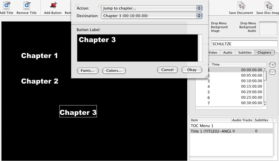

    I have a fairly simple project (as noted above). I have 9 episodes in mpeg-2 format (converted from Mpeg-1). I dont need any fancy hierarchical menus - just one intro menu with buttons for each of the 9 episodes.
    But looking at the help in sizzle, and the tutorial referred to in this group, I cant figure out how to ONLY do a one-level menu. I see the "add title" button and the stuff for adding chapters, but cant figure out how to do ONLY one top-level menu with 9 buttons, each going to one of my 9 files.
    Can someone offer a hint on how to do this with one menu? Am I adding titles to the front menu? I can't seem to do it that way.

  4. Sizzle starts with the TOC menu and needs a menu for every title according to the Help documentation. You may be out of luck. If you are burning with Toast, you could always use it to create a simple menu for you. There is a tutorial around somewhere for switching out the menu background image. Otherwise you may have to go with iDVD or DVD Studio Pro.
    indeed that's it.
    if you have your 9 episodes in one m2v file you could put the 9 episodes buttons on the title menu (where you go from after the TOC) and each episode-button can jump to the desired chapter.
