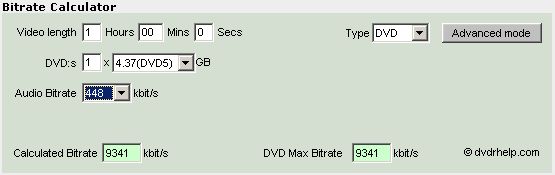

I think *greater* is very debatable. With CBR, plug the time into the bitrate calculator, use that bitrate and it will fit, simple as that.Originally Posted by vhelp

If you can't fit 60 mins of video on a DVDr using CBR at 9000kbits either you are using PCM audio or you are doing something seriously wrong.
There you are right, one hour WILL fit on a DVD disk, no suprises there.Originally Posted by vhelp
