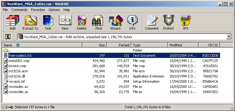

  5. Originally Posted by spiderman03
    the name of the audio that is used in the files is voxware metasound ,unsuppported......what's the next step
    Get a Voxware Metasound codec:
    http://www.free-codecs.com/download/VoxWare_MetaSound_Audio_CoDec.htm
  6. how do i install this voxware metasound, i can't seem to do it
  7. VH Veteran jimmalenko's Avatar
    Aug 2003
    Down under
    Once you've downloaded the RAR file, open it with WinRAR.
    Press Ctrl-A to select all files. Press the Extract To button, and specify a directory to extract these files to. Once you've extracted the files, browse to that directory, right-click on the voxacm.inf file and go to Install.
