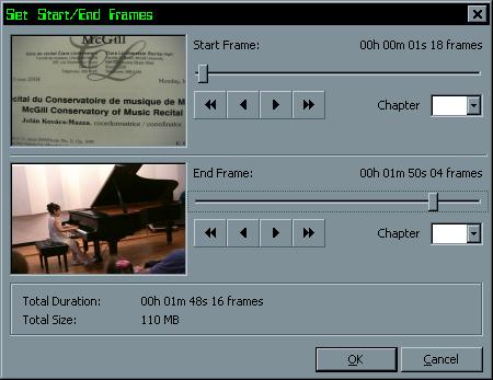

I have already completed my Christmas Movie Triva Project and I used DVD Shrink. Use the edit (Start/Stop Feature) to cut the part you want to keep. Save each file to a separate folder. I used the 3.0 Beta 5 version of DVD Shrink to pull each file into DVD Author window (This version opens up a second window, just like the first one, drag and drop from one window to the other) and burned the resulting file with nero. This essentially creates chapters for you (without) the menu of course. Use your remote control to start stop, forward to the next video clip while playing your triva game. It took me under 2 hours to do 15 movie clips. I don't know what you mean by work with later on. I can only assume you might want to pull them into an authoring program. Several programs support VOB files. Just don't try and over engineer your project. You'll impress them enough with the method I pointed out. Good luck.
In DVD Shrink's Reauthor mode, drag your title from the right area to the left, then select Start/End Frames. Click Backup!

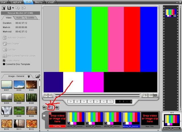

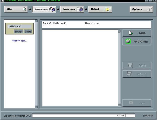

Repeat as necessary. Open the resulting folders in TMPGEnc DVD Author or Ulead DVD Workshop 2, or whatever authoring application opens DVD folders.

the only problem i am having is when editing with dvd shrink, there is no sound in that window so it is really hard to edit frames unless you know for sure which frames you know. And since I specifically need songs from the movies I need to know when exactly the song starts and ends in a clip -
You could overshoot the size of the clip a little in DVD Shrink, then trim it more precisely in your Authoring app. Either of the two mentioned above allow you to do that. Either that or note down during playback beforehand where the song starts and ends.
