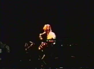

    LS: I've included an image of the type of video I'd like to restore. As you can see the tape still has color, but it's very dark. This video was filmed back in 1984 on a consumer camcorder, so I'm not sure what the limitations of enhancement would be.

  10. Video Restorer lordsmurf's Avatar
    Image too small to help.
    Looks dark. What else?

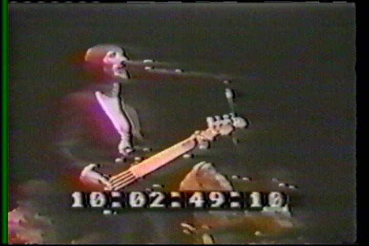

    Here's a "worst case scenerario" of the types of video I'm trying to clean up. The green bar on the left is from converting a PAL VHS to NTSC using a comworld video convertor. That can be masked, no big deal. I know there's nothing I can do about the timecode bar. As you can see the color is still there, but it's a bit washed out and the color seems to have shifted.
  13. Video Restorer lordsmurf's Avatar
    Well, that can be improved with the Elite, this I know. Maybe gshelley will come back to comment on the SignVideo potential.
    The black level would be handy (maybe), would have to turn several knobs, that's for sure. Several problems I see here.
  14. I agree with LS. The BVP-4 is better suited to deal with something in this kind of shape, definitely.
    Agreed. The tape is of unkwown generation. My guess it's from an NTSC source that's been converted to PAL and I'm converting it back again. I'm shcoked there's any color left in it at all. Then there's the saying "garbage in garbage out". But sometimes this is as good as it's going to get. I archive rare Pink Floyd and related video and most of the time the sources I find are less than ideal. I may start with the sign video processor only because the company has a 30 day money back garentee and see how that does. Thanks for the advice Lord Smurf and GShelly.

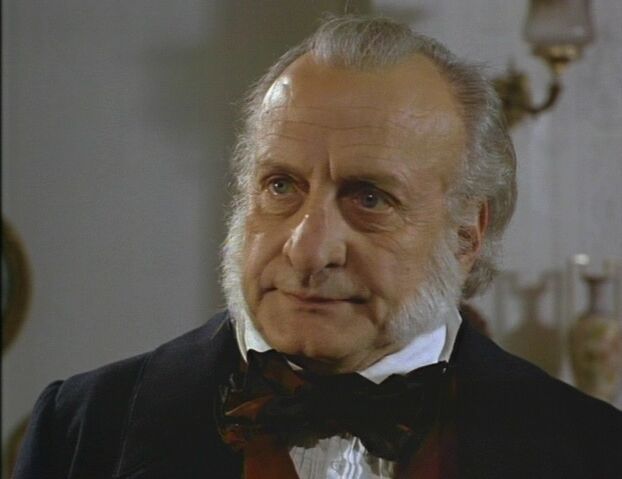

  16. Here's an example of what enhancement can do for a good video source...
    First, a frame from A Christmas Carol laserdisc with George C. Scott as Scrooge. This is straight from the composite out of my Pioneer CLD-D704 laserdisc player and captured to MPEG2 with a JVC DR-M10 DVD recorder set at FR100 (one hour, forty minutes):
    Same frame, but this time the composite video signal was enhanced (sharpened) with a Vidicraft Detailer III and color corrected with the SignVideo Proc Amp (mainly the black and luma was adjusted):
    When played back, the enhanced version looks more dynamic and film-like... and the blacks look black. The unaltered one looks pretty good, but is a bit soft and a little hazy. Keep in mind the JVC DVD recorder does some very mild automatic enhancement and noise reduction during the encoding process, which makes even the unaltered version look pretty decent.
