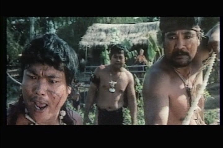

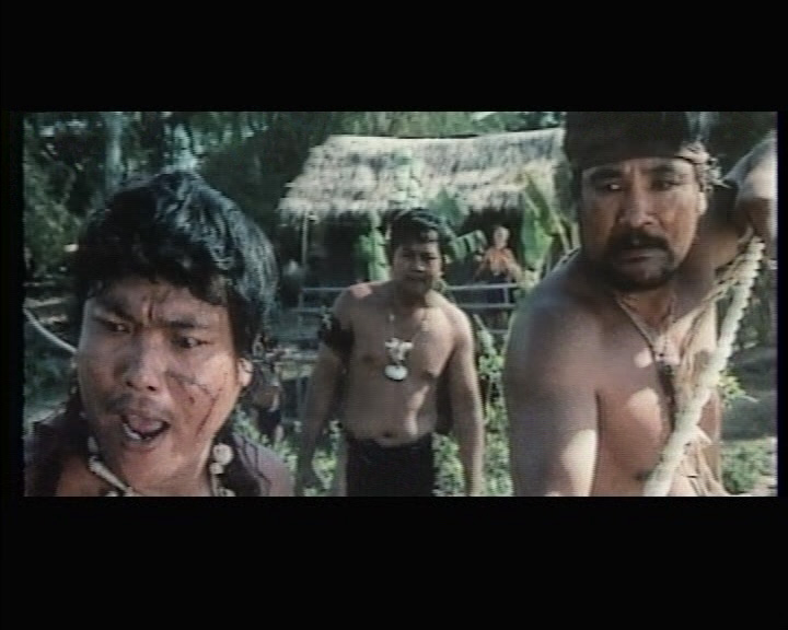

Here is an original PAL DVD image (720x576)
Here is the PAL image cropped to 720x480
Here is the PAL image resized to 720x480
To make it easier to "see" the difference here is the cropped image (left) and the resized image (right). Both reduced by 50% so you can see them side by side more easily on your computer monitor ... thus making the difference more noticealbe.
As you can see they look different. The resize method is the proper method when going from PAL (720x576) to NTSC (720x480).
