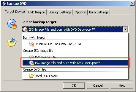

Thanks. That's the second time I failed to go deep enough into the Shrink menus. The program looks so straightforward that a guide would not be necessary. Deceptive ease, you might call it. But I have gotten lost in this program a few times, trying to do certain things. In fact, the menu you pictured in your reply -- I've seen it a couple times, but haven't managed to find my way back to it since. -
Originally Posted by jimmalenko
It should be hard to miss, for those with a better idea of what they're doing than I bring to the party. First, you have to come in through Re-Author mode, or for sure you'll never see this menu. Then, you have to not go right past Source (which normally shows your DVD burner), somehow thinking this item is hard-wired and unchangeable. Believe me, I've made plenty of wrong turns much worse than this one.

Part IV: Burning the ISO File.Originally Posted by nzo
Now for the final part, burning the ISO file you have just created, or should I say DVDShrink has created. Go to DVD Decrypter -> Mode -> ISO write. Click the browse icon and locate your file.
I followed your step but I can't find the ISO file but rather BUP, IFO, VOB files only. What did I do wrong? Is there a setting in DVD Shrink that tell you what kind of output files you want? -
I really appreciate your fast response. Indeed, I overlooked that section and chose Hard Disk instead. Million of thanks!
