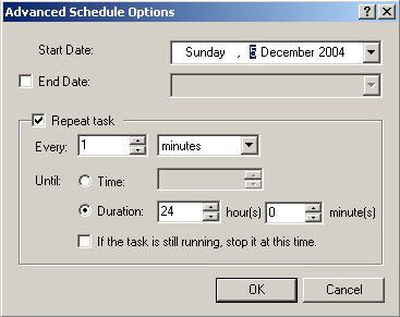

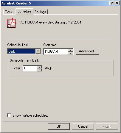

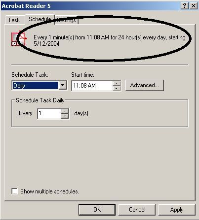

    Windows scheduled tasks can do it for you every minute.
    Set it up to run (once) daily:
    Then use the Advanced button to set it to repeat every minute for 24 hours:
    This then adjusts it so that it runs every 1 minute for 24 hours every day (of the week) and it's reflected here:
