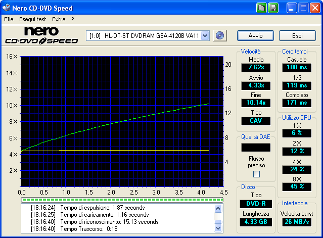

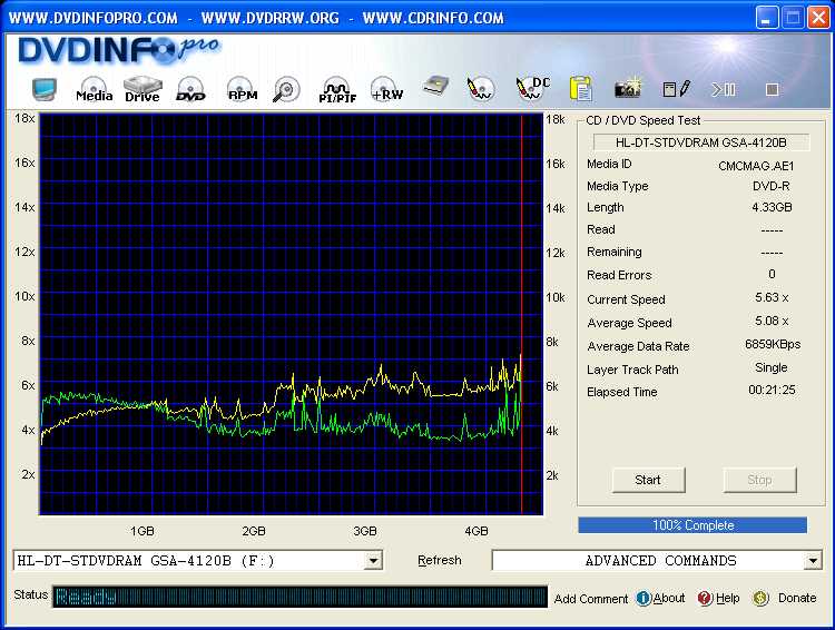

    I also perfomerd a speed test with Dvdinfopro :
    and with Nero :
    Nero appears to be perfect but what about the other ?

    The scans show CMCMAGAE1 media, not RITEKG05.
    So ....... which is it?

    The object of the topic was RitekG05 and with them I have PI values always higher than 350 and an AVG of 400. These values tell me that these disks aren't good for my writer, even if I have no problem with standalone player.
    I introduce then the picture of CMC scans to ask somebody the reason of the different between the nero curve and Dvdinfopro curve.
    The AVG of Pi values of CMC MAG AE01 is below than 20.
    But this last PI scan is obtained with a combo drive. (not LiteOn). Is there a program similar for LG writers ?
