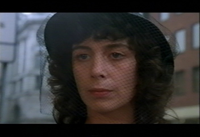

    MAK

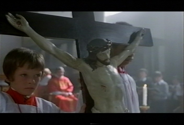

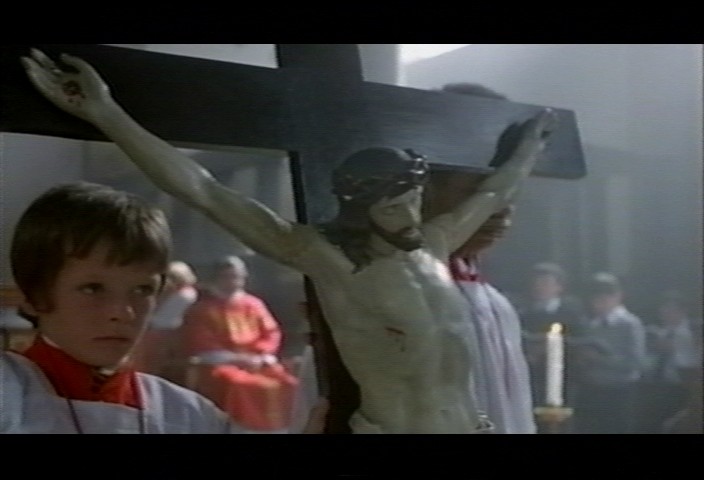

  20. Member BrainStorm69's Avatar
    Aug 2002
    Texas, USA
    Well, since tdweis said the tapes he wants to convert are of TV shows he's taped, I taped part of a movie off my cable channel with my Toshiba M-784 VHS VCR. Then I capped them from my JVC HR-S9900U using both s-video and composite cables. I have to say there isn't much discernable difference between the two.
  21. Video Restorer lordsmurf's Avatar
    Images don't show up?
  22. Member BrainStorm69's Avatar
    Aug 2002
    Texas, USA
    Well, that's strange. Hmmm....I'm not sure why it isn't working.
    ***EDIT***
    OK, converted to jpg and uploaded instead.

  24. Video Restorer lordsmurf's Avatar
    edDV, those links are TOTALLY WORTHLESS for the conversation at hand. Those tests use high-resolution test patterns. This was about VHS tapes and s-video versus composite.
    As BrainStorm69 has illustrated, there won't be any real difference between the two of them on something a "lowly" as VHS source. Not at all.
