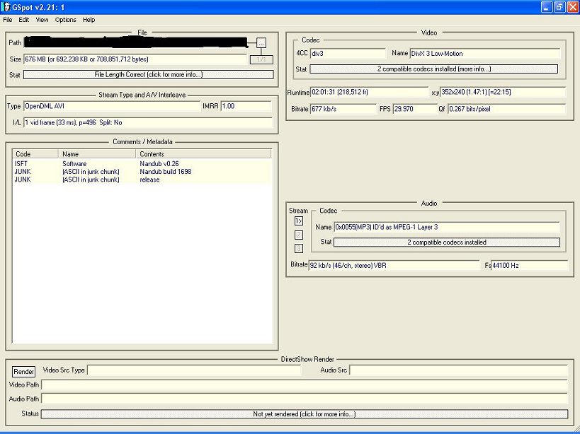

  6. Here you go
    http://www.imagestation.com/picture/sraid148/p7736446a48ed3786139e7401ec96b01a/f60accad.jpg.orig.jpg[/img]

    Can anyone actually see that image?

    something funky going on here ...

    What do you mean ? If its because of the blacked out box, thats only to cover up my name and personal info.

    Ok, you've got the dreaded VBR MP3 audio to start with - load your AVI into Virtualdub and use this guide to extract the audio out to a WAV file.
    Next, make sure you have the divX 3 low-Motion codec installed - even though it says you have two compatible codecs, you might need the actual codec itself, and not just a later version that can decode it.
    If worst comes to worst, you could always open the file in virtualdub and frameserve to TMPGEnc using this guide.
