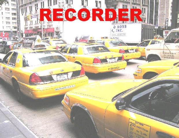

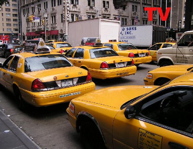

  11. Heres what I mean about the Tuner Being Bright, it looks like this.
  12. Member tipstir's Avatar
    Jul 2003
    Connecticut
    Wow your contrast (picture), brightness are way off.
    Did you say you used both RF IN and RF OUT, Don't use the RF OUT and just the RF IN. Can you send a signal to your 5101 through the A/V and record something and see if you get the same results? If you do take it back to the store for another one. You might have got a bad one?
    Best Regards,
    Tipstir
    MediaMVP Supporter
  13. The Cable/Coax coming from the wall goes into the "IN" of the Recorder, then i take the "OUT" and send that to the Tv..Is this not how i should do it?

    No don't do it that way..
    I use a high quality low loss 2.5GHz splitter and that connects directly to the DVD Recorder RF IN.
    I have Comcast Digital and Analog Cable feeds
    So I use the splitter for analog channels 1-99
    I use A/V-IN/OUT amp splitter for digital channels 100 and up. That connects directly to the A/V on the Liteon 5101 rear.
    You might not have the same type of Motorola Digital Box and your cable might not do analog cable.
    Does your TV have A/V connectors?
    Can you hookup a VCR connected to the cable and then use the A/V out to the Liteon In on the front to see what type of Picture you get and post it here.

  15. I have 6 A/V inputs on the TV.What you said about the spliter sounds good. So i should Split the Cable/Coax to the TV then To the Recorder,then from the recorder use Svideo out to the TV With Audio cables?

    Yes!

  23. I solved the Washed out/Brightness problem by Using the Tuner in my Sony VHS, I even tried using my Tuner from my TV it has 2 , and the Problem was still there.The tuner, I think maybe the Downside of this set up.
