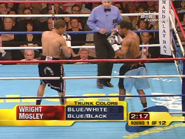

	Here is a sample clip and here are the specs:
 Resolution: 704*480
 Video: MPEG-2
 Audio: 48000 Khrtz
 Bitrate: Around 3,200kb

 edit: of course I know that posting that one vidcap just resulted in about 10 people who were on the fence about buying a HDtv going "Ok I have to get one now" hehe
	Well the DVB card does actually capture the same stream as a normal HDTV card will. Same resolution same everything, difference is that my card caps it in mpg and urs in ts files. but overall the stream is the same..
 As for the cap i displayed, it is shrinked and yes doesnt look good but u need to see it in real life...... If im allowed to post a link to a 20 second clip I would? anyone willing to host it for a week?

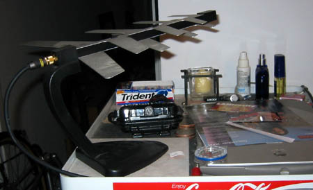

 but anyways, for me, it's just this little silver sensor sitting all ghetto like in the cpu room on a 30cent tile from a hardware store.. Compass near it was to tune it for the direction as listed for my location by http://www.antennaweb.org
 but keep in mind, I do live in a top 20 tv market and only 25 miles from the main broadcast towers. So it's very easy for me to get over the air HDtv for all the networks. Where in some areas the ONLY way to get HDtv is going to be sat/cable... That is where the idea of a cable tuner HDtv card or this DVB card starts to kick in and look good to some people.. Free over the air is great if [big if] you can get it..
