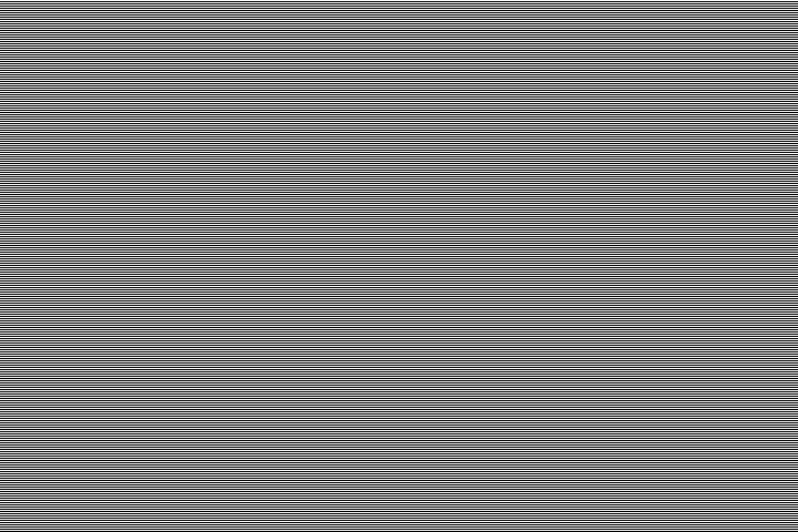

  8. Any interlaced video, PAL or NTSC, converted or not, can flicker under the right conditions. Try burning this image to an NTSC DVD:
    The flicker will knock you out of the room.

    Well the flickering is much more frequent than that which I've seen in any NTSC videos. I can see flickers much more often when the video is panning to a certain direction, or as I said, in scenes with much motion.

    Sorry, I missed that. That's not the type of interlaced video flicker I was refering too. Unsmooth motion like you describe is generally a problem when converting from PAL to NTSC or vice versa. Software conversion can do better but it's a lot of work to do it properly (see some of the guides at this site for more information). It's an issue of displaying a 25 frame per second video at 29.97 frames per second. The only way to do it is to duplicate a frame (or field) here and there. So there will be a slight pause now and then -- leading to jerky motions. It's most obvious in smooth pans or when a large object moves smoothly across the screen.
