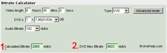

  12. Here you go, I thought video and audio bitrate play the role in how much space is gonna be taken up on a cd ? Also on the bitrate calculator what does calculated bitrate mean ?

    Yep, you've got VBR MP3 audio, which TMPGEnc don't like at all. It often reacts by thinking that the movie is much longer than it is, and this is proven in your pic with you saying the movie is 94 minutes long, whereas TMPGEnc thinks it's 241 minutes long. Save the audio out to a WAV file using this guide.
    The calculated bitrate is the video bitrate you need to specify in TMPGEnc. If you're doing CBR then set the bitrate to this value. If you're doing a 2-Pass VBR, you set the average to this value, your max to something near 9000 and your min to about 1000 (IMO). BTW, I'm pretty sure you can change the res to whatever value you want in the wizard. My personal preference is to use the "manual" mode, because IMO you have a lot more control over every minute detail.

  16. But I'm talking about the bitrate calculator, there are 2 parts
    Calculater bitrate which I don't know what its used for
    And DVD max bitrate, I have been using this number and putting that into tmpgec

    Good lord, no wonder you've been having so many issues ...
    1. is the bitrate you need to put into TMPGEnc, because it is the calculated bitrate. You should always be putting this into TMPGEnc.
    2. is the max video bitrate you could use to keep the DVD within the DVD spec, and is simply 9800 minus whatever you set your audio to. Try changing your audio bitrate and see how that value changes, yet it doesn't change when you change the running time of the video. You should never be putting this into TMPGEnc.

  18. Actually last time I used the calculator was about 2 weeks ago and now that I think about it, I used the calculator number.
