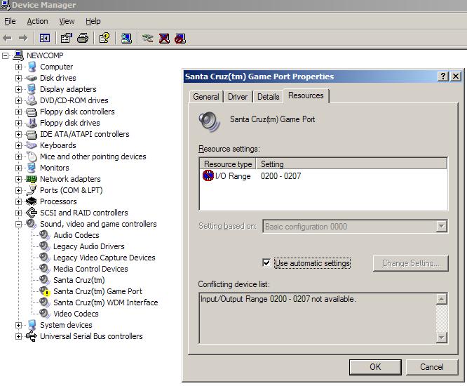

Having some resource problems with a game port on my sound card (Turtle Beach Santa Cruz (OEM from a Dell)):
I do not really have experience with resource conflicts... I disabled my serial port (from BIOS) and also my integrated modem and audio are disabled... Don't know if that helps.
How do I resolve this conflict?

Try this:
Power down, remove all cards except for video and the card with the game port. If there are no other cards, try disabling the built-in functions in the BIOS except the video.
Restart and in Device manager, refresh it. It will reinstall the card and hopefully assign the Memory range the game port wants.
Then power down and reinstall the other cards. Power up and let Windows auto-detect and install the hardware.
If that doesn't work, try unchecking "automatic" from the screen you posted. Try reassigning the address. Sometimes this doesn't work, but give it a try. -

You need to find out what the device is conflicting with. In device manager choose View -> Resources By Connection. Look in the Input/Output Section for a device with the same memory address. Then you have two options:
1. If possible disable or remove the offending device.
2. Uncheck use Automatic Settings and change the memory address to one which is not in use. If this is not possible on the Game Port it may be possible on the other device. -

Capmaster's method did not work for me
Also, I tried manually setting values for the resources but I could not find a working range...
In device manager, using Resources by Connection view, I don't even see my sound card there.
I've tried two other PCI slots besides this one, I guess I'll try the rest
I have no other PCI cards, just an AGP graphics card.
If it does not work, too bad
, but I won't get a new sound card just for the game port...
If you can't find your soundcard look for the device using the range 0200 to 0207 and then your back to the two options I gave you. You are best to look in 'Resources By Connection' view otherwise you'll be there all day.Originally Posted by mujahid7ia
