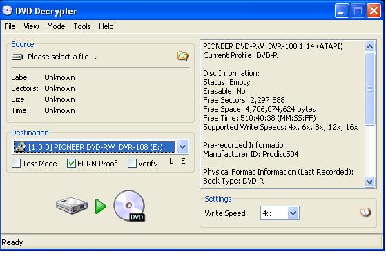

    I have tried on my Toshiba 3900 and Toshiba 1200 and a PS2. Here's a screen shot of the ProdiscS04 from DVDDecrypter.
  6. well thats a crapper.. ok maybe I will stick with G05's they burn at 12x with no problems..
