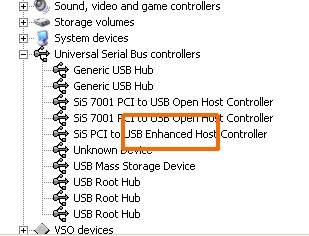

  3. Member Dr. DOS's Avatar
    Sep 2004
    Mid Atlantic
    Just to confirm make sure your \ System \ Device Manager \ USB Contollers has the word "enhanced" regarding the host controller. If it is there then system and drivers are setup / working with USB 2 hardware.
