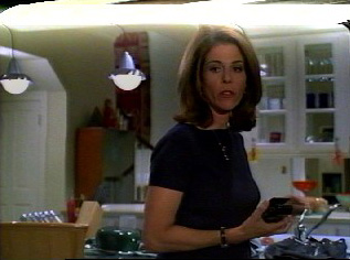

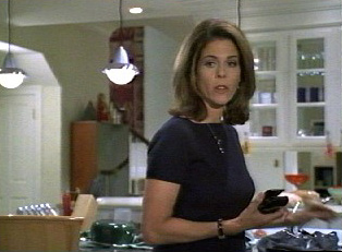

    Samples:
    Image as it SHOULD be:
    Image with false anti-copy error ruining it:
