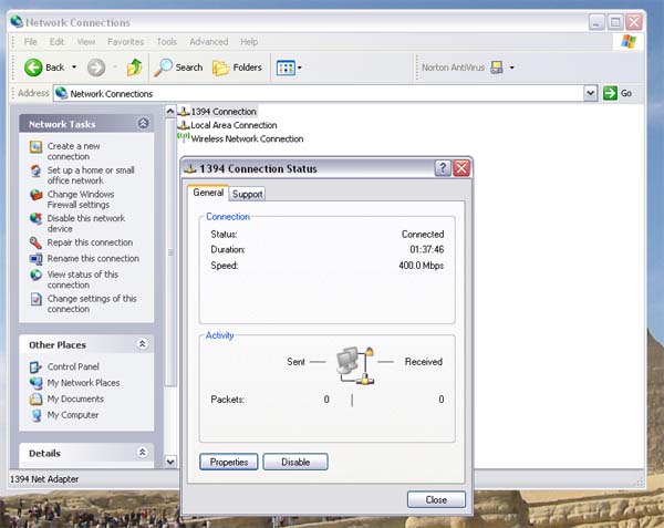

  3. On my WIndows XP rig, my fire wire port is seen by windows as a networking device, though never used as such it shows in the 'networking' tab of task manager as 400Mbps network bridge (or something like that). If your set up is similiar it may show data transfer speed when the firewire is in use. Take a look.

    I don't think the Firewire transfer rate will show up in networking unless you are using Firewire for networking in place of a Ethernet connection.

    Firewire will ALSO show up as a network port. But it should also be listed as actual ports if installed and working properly.

    This is the closest I've seen to a firewire speed monitor in XP:
