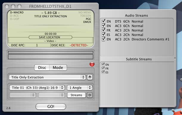

for the guy that wants to know about the dmux operations, it does not dmux all the streams , just the audio track you choose , and the m2v stream , so you could extract movie.m2v and say the English , 6 channel audio , leaving all the rest behind.... you can then drop this into sizzle , dvdsp3 and do what you wish.
the dmux ui tells you all you need to select the correct stream.
Im still deciding what to do about subtitles , cant be sure if ripping a track of subs is worth it.
As the dmux is done on the backend of the title - title/chapter mode , there is no drop in speed.
one issue i have to correct , and its been in mTR for a while , i have an issue of the "PATRIOT" that declares it has more chapters that it realy does in the IFO , so when you pre-scan the location to aquire sector addresses for these blocks..... CRASH.... and if you try to rip these incorrect chapters -- CRASH...so , i have to decide in a trade off between a little longer pre-scan time to check the validity of chapters ... ( maybe just check the end chapter and work back untill a valid one is found ) or povide a chap.... either way the chapter count of an IFO needs a sanity check.

one thing..... the dmux buttons ... would you like them in the main UI , or maybe a new TAB called DMUX (etc ) would stop over crowding...
oh , the dmuxer does stip DTS correctly too.

I think 'Demux' should be a checkbox in the title/chapter mode window, and next to it should be a button titled 'Stream selection' (or just 'Streams' if there isn't enough space) which becomes active when 'Demux' is checked, and opens a new sheet where the user can deselect unwanted streams (they should all be selected by default). We may have to make the window larger to accomodate this, but it would provide the most intuitive interface for this functionality, since a demux tab would be useless in any mode but title/chapter. For subtitle streams, I'm not aware of any mastering apps being able to use demuxed subtitle streams (.srt). If anyone can comment on their usefulness, maybe we can include them too...
As for the chapter scanning, as long as it only happens in title/chapter mode, I don't see a problem with it taking longer to scan if it's going to prevent crashes on some discs.

the button and stream popup is already in the method tab , due to the optimisation ( for speed ) you can only extract 1 m2v and 1 ac3 - or - dts stream....

right.... wise wanted a choice off selected audio streams to be ripped....
ripping multiple streams at the same time hits on speed , but i have made the relative changes to the code and now it will work... the current ui is inadeqate for the multiple stream selection , so i will move it into a side draw , or a sheet with checkboxes and the current stream(s) details next to it.
much better i think

here it is... i did a test , full movie vob rip , full movie demux all channels ( 4 ac3 + 1 DTS ) the demux rip took 5 seconds longer.
6 gigs in 12 mins
That's looking pretty good. I don't really understand why the audio stream selection has to be in a drawer rather than a sheet, but it looks good anyways, so it's fine this way too... I don't know if there's an easy way to get the size of each audio stream, so that the extraction size in te MTR window can reflect the number of streams selected, but that would be a nice addition, if it's easy to implement. If not, no big deal... Regardless, it's looking good. It would be nicer if checkboxes were only generated for existing streams, like the text (i.e. 3 checkboxes for 3 streams), but the way you've implemented them, it looks like that would kill 10.2 compatibility. Also, if possible, the drawer should be less wide, since the text couldn't possibly fill that whole area (I think). Overall, this will make a great addition to MTR, and I'm really happy to hear about the speed optimizations. With that insignificant difference in speed, I think we can default to all audio streams selected, and have users deselect streams they don't want.
I like systems, their application excepted. (George Sand, translated from French), "J'aime beaucoup les systèmes, le cas d'application excepté." -
Sheets = non modal = cant keep the sheet open AND start Extraction...
Drawer is this wide coz some ( most ) dvd's describe the audio content ( i.e Directors ~Comments )
cant compute the audio size coz DTS - AC3 - PCM sizes Vary
maybei can gen the boxes on build / stream counter... have to see

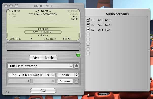

right .. audio stream NSbuttons now only reflect the current count of streams per title ( as requested )
Due to the fact the 10.2 does not support the visible control method , i subclassed NSButton , and overroad the Drawrect method.
Works a treat.

right done the subtitles for the ui now.... yes the buttons are small , but as one stream can have 32 subtitle streams we need to cram 32 little buttons in there just in case.....
That's beautiful! Nice work there, really! It's looking perfect. I look forward to releasing this baby. Can't wait to get my G5 back from the shop so we can release, and I can take care of giving out all the donation info. This has turned out to be quite the impressive update!
