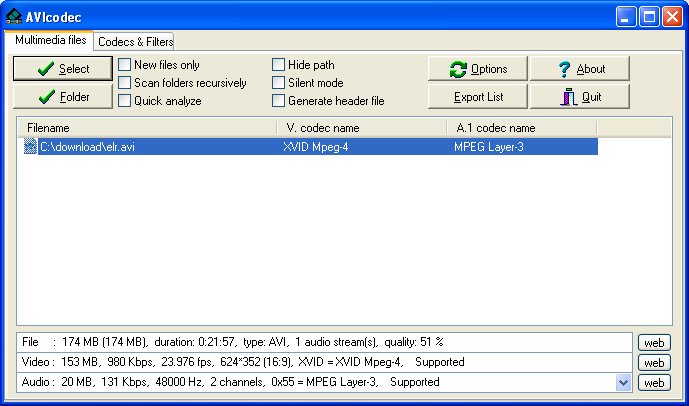

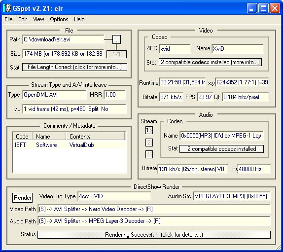

If it says Mpeg-3 that means that the audio is MP3. To find out about the video use a program like Gspot or avicodec and make sure you have the required audio and video codecs installed on your system.
Now you can go to the guides section and under format conversion you can look up a guide pertaining to what you are trying to accomplish, for instance "avi to vcd" will get you this list.
I recommend TMPGEnc for your conversion to mpeg.

You have an avi file, the video portion uses the xvid codec and the audio is MP3.
TMPGEnc problems? Look here."Art is making something out of nothing and selling it." - Frank Zappa -

You just have to resize to 720x480 and set the display aspect ratio to 16:9 in your encoder. DVD, unlike VCD, accepts true 16:9 material (not 16:9 letterboxed to a 4:3 window). You also need to do a pulldown (it can be either be set within the encoder or running pulldown.exe when you're done). If you use tmpgenc you specify 23.976 in framerate and 3:2 pulldown when playback in encode mode. Since your footage is very short you can max out the video bitrate without problems. CBR 9000 will do. If you decide to encode your audio to mp2 make sure to install toolame (see tools section) and point to its path in tmpegenc (under environmental settings, audio engine). If you use PCM lower your videobirate a little (something like 8200 to play safe).
EDIT: re-reading your gspot scan I realize that CBR 9000 will most likely be overkill for the material you have. Something like 2-pass VBR 6000 min 2000 max 8/9000 should yield the best quality you can expect from such a source. Again, not seeing the source I'm just guestimating. Try playing with the bitrate a little and see what looks good to you. I was suggesting CBR 9000 because you only have 20 minutes of footage and you can encode at the max bitrate available.Sorry, I had to go see about a girl -

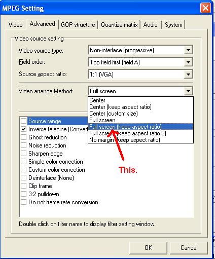

The source avi in question was recorded in HDTV format and I was wondering if there's a way to keep that aspect ratio? Silly question?
Thanks -
Are you following a guide? It would answer some of your questionsOriginally Posted by hammerin_hankster
Anyway, you need to select full screen (keep aspect ratio) under the advanced tab.
