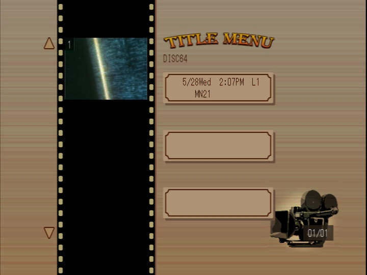

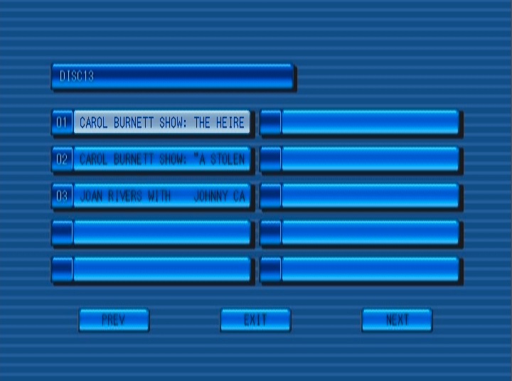

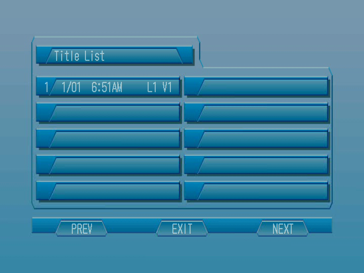

    By the way, if you don't mind, I'd like to ask if you recognize the 3rd attached picture saying "BEST VIDEO QUALITY" by any chance? I'm desperately searching for a DVD recorder that creates this Menu title page. It is NOT because I love the DVD menu title page. It is because the captured video quality from the DVD recorder that creates this DVD menu page is AWESOME. The Max bitrate is 9300kbs, the average bitrate is 9299kbs, and the minimum bitrate is 9017kbs. This result is obtained by using Bitrate Viewer. The DVD being read has no subtitle tracks and contains only 1 single audio track.

  27. Having looked thru my own collection of DVD dubs made by various Pioneer recorder models, and downloaded the full dvd examples you sent me via PM, I might be able to clarify some of this.
    First, the menu page screen caps above do not all match the sample dvds you linked to: the bottom does match your preferred example "Lady Yang", but the two above it do not match either "Bloody Pearls" or "Love Me Again" (the menu design is the same but the dates are different on the video samples).
    I can provide some guidance on the above Pioneer menu caps, which could be helpful assuming you yourself do know which actual dvds correspond to the dates/times shown. The first/top menu cap is from an earlier Pioneer model range, 210/510 or 220/320/420/520/920. Those models had an instantly recognizable, larger thicker typeface in the date/time/title and other menus, designed for the older CRT television displays. The "MN31" recording mode (65 mins per dvd) is one step below maximum XP (60 mins per dvd). Again assuming source tapes of very similar quality, this would be the maximum transfer quality possible with that recorder model. The drawback to these older Pioneers is they can be unpredictable with VHS input: these seem to be commercial tapes of very high quality and no copy protection, which is the only kind I would recommend for these older Pioneers. Any other source tapes tend to encode with various unpleasant artifacts, as these early Pioneers had very weak input buffers optimized for broadcast signals or external tuner boxes.
    The middle/second menu cap is from a later Pioneer, but it is impossible to say exactly which model as the menu design did not change again after the shift to thinner lighter "HDTV typeface" with the DVR-530 series. This could be any of a dozen models from the x30, x40, x50 or x60 series, sold between 2005 thru 2008 respectively. The MN21 recording mode indicated is the manual incremental equivalent of "SP" which provides 120 mins per dvd. Note this would be approx half the bitrate of MN31 or XP, so is not directly comparable to your other two examples (not a fair test of this recorder).

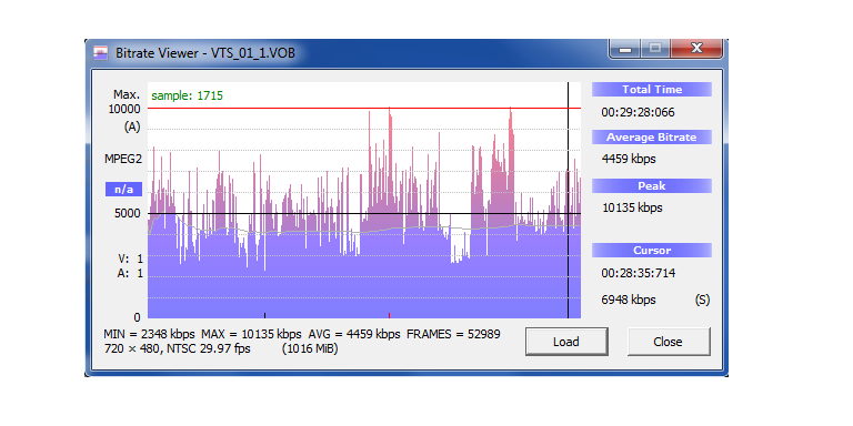

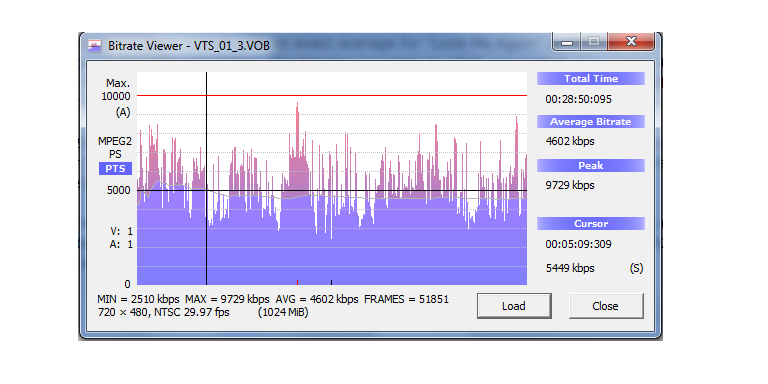

    Regarding the sample DVD links you sent me:
    The dvd corresponding to your third (blue) menu cap above, "Lady Yang", is of extraordinary high quality: among the best VHS to DVD recorder transfers I've ever seen in compromise of noise vs smoothing vs realistic detail. The difference between it and your other two dvd samples is dramatic: those are very good, and typical of what I myself would usually be content with. But "Lady Yang" is just incredible: it actually looks too good to have come from a simple VCR>DVD recorder capture system. It surpasses even some top-quality dubs I've made with classic JVC and Toshiba XS recorders and premium VCRs: whatever combination of tape, VCR and dvd recorder made the "Lady Yang" dvd was something special.
    HOWEVER: something is also a bit off with "Lady Yang". The bitrate identifies as 9300 vs the 9500 of your other two Pioneer samples. More significantly, it will not play properly in either VLC or MPHC on my Windows 7 PC. VLC can't proceed past the menu, and MPHC crashes altogether. The only software player that works with "Lady Yang" on my PC is KMP (odd, because that is usually inferior to VLC in compatibility). Of course, my PC is just a single test case, but it tends to make me think this dvd recorder employed a somewhat off-spec format to its VOBs or encoding. If its a Sony, highly unlikely to be a modern-era model since those work like Pioneers. If this does prove to be a HX900 as you believe, I would still be very leery of purchasing one all these years later. Even if the recording quality is amazing, inability to burn dvds and probability of random hard drive corruption (after you put hours or weeks effort into a project) could make for a poor, unproductive tool.
    "Bloody Pearls" appears to have been dubbed to a Pioneer x50 or x60 series recorder. Given the source tapes are very clean, I suppose it could also have been a x30 or x40, but in my experience those typically add a more noticeable smoothing effect. The 9500 bit rate implies an XP or MN31 recording mode. This sample (to my eyes based on what I usually achieve with a Pioneer 550 or 560) is typical of what one can expect from a Pioneer: I would be happy if I could always get such a result (other than the dropouts and other unavoidable tape age defects). Unfortunately most of my source tapes are not as free from chroma noise as yours.
    "Love Me Again" strikes me as the most common "OK-good" result an average person could get from a simple VCR>DVD recorder setup. Color and chroma noise levels are acceptable, but there is some clarity loss with a fuzzed/smoothed somewhat plastic effect (disappointing considering this is also 9500 bitrate XP/MN31). This is far more prevalent in VHS dubs made with the Pioneer 540/640 series vs the later 550 or 560. The specific signature of the "blurriness" (for lack of a better word) in "Love Me Again" strikes me as the type specific only to the Pio 540/640 encoder (rather than similar effects one often observes from a TBC/DNR equipped VCR). Without verification of the exact VCR and recorder models used, or the condition/quality of "Love Me Again" tape vs the others, it would be hard to say with certainty why this sample is less satisfactory than ""Bloody Pearls".
    I cannot identify or verify the (seemingly superior) recorder brand/model based on the "Lady Yang" blue menu screen cap (above). This was a very common design for ten-title, text-only menu option across multiple recorder brands over many years, with just slight variation in the details. See below for the version that debuted with the Pioneer x40-x50-x60 (x10-x20-x30 did not have this menu option at all). The Sony RDR-HX x70, x80, x90 would be near identical, possibly the RDR-HX x50 as well. Note many Sony DVD/HDD models use the same "MN31, MN21, etc" names for manual recording speeds as Pioneer.

    The dvd corresponding to your third (blue) menu cap above, "Lady Yang", is of extraordinarily high quality: among the best VHS to DVD recorder transfers I've ever seen in the compromise of noise vs smoothing vs realistic detail. The difference between it and your other two dvd samples is dramatic: those are very good, and typical of what I myself would usually be content with. But "Lady Yang" is just incredible: it actually looks too good to have come from a simple VCR>DVD recorder capture system. It surpasses even some top-quality dubs I've made with classic JVC and Toshiba XS recorders and premium VCRs: whatever combination of tape, VCR and dvd recorder made the "Lady Yang" dvd was something special.
    HOWEVER: something is also a bit off with "Lady Yang". The bitrate identifies as 9300 vs the 9500 of your other two Pioneer samples. More significantly, it will not play properly in either VLC or MPHC on my Windows 7 PC. VLC can't proceed past the menu, and MPHC crashes altogether. The only software player that works with "Lady Yang" on my PC is KMP (odd, because that is usually inferior to VLC in compatibility). Of course, my PC is just a single test case, but it tends to make me think this DVD recorder employed a somewhat off-spec format to its VOBs or encoding. If it is a Sony, highly unlikely to be a modern-era model since those work like Pioneers. If this does prove to be an HX900 as you believe, I would still be very leery of purchasing one all these years later. Even if the recording quality is amazing, the inability to burn DVDs and the probability of random hard drive corruption (after you put hours or weeks effort into a project) could make for a poor, unproductive tool.
    "Bloody Pearls" appears to have been dubbed to a Pioneer x50 or x60 series recorder. Given the source tapes are very clean, I suppose it could also have been an x30 or x40, but in my experience, those typically add a more noticeable smoothing effect. The 9500-bit rate implies an XP or MN31 recording mode. This sample (to my eyes based on what I usually achieve with a Pioneer 550 or 560) is typical of what one can expect from a Pioneer: I would be happy if I could always get such a result (other than the dropouts and other unavoidable tape age defects). Unfortunately, most of my source tapes are not as free from chroma noise as yours.
    "Love Me Again" strikes me as the most common "OK-good" result an average person could get from a simple VCR>DVD recorder setup. Color and chroma noise levels are acceptable, but there is some clarity loss with a fuzzed/smoothed somewhat plastic effect (disappointing considering this is also 9500 bitrate XP/MN31). This is far more prevalent in VHS dubs made with the Pioneer 540/640 series vs the later 550 or 560. The specific signature of the "blurriness" (for lack of a better word) in "Love Me Again" strikes me as the type-specific only to the Pio 540/640 encoder (rather than similar effects one often observes from a TBC/DNR equipped VCR). Without verification of the exact VCR and recorder models used, or the condition/quality of "Love Me Again" tape vs the others, it would be hard to say with certainty why this sample is less satisfactory than "Bloody Pearls".
    I cannot identify or verify the (seemingly superior) recorder brand/model based on the "Lady Yang" blue menu screen cap (above). This was a very common design for eight-title, text-only menu options across multiple recorder brands over many years, with just slight variation in the details. See below for the version that debuted with the Pioneer x40-x50-x60 (x10-x20-x30 did not have this menu option at all). The Sony RDR-HX x70, x80, x90 would be near identical, possibly the RDR-HX x50 as well. Note many Sony DVD/HDD models use the same "MN31, MN21, etc" names for manual recording speeds as Pioneer.
    #Orsetto,
    ++ The first menu page screen cap with bigger text size is from the Pioneer DVR-220S I bought and also will return it to the seller by tomorrow.
    ++The second DVDmenu screencap with thinner text is the Pioneer model I'm trying to locate. I know it is impossible to tell which models exactly, maybe I will have to do my own trial-and-error procedure until I find the answer.
    Actually, the LADY YANG DVDs (40 DVDs total of the same bitrate of 9300kbs, these DVDs play normally on my LG, Samsung, and Sony DVD players) play perfectly across all my 3 different computers (2 Win7 professionals, and 1 Win10). I only use the VLC media player to play all my files. I set the MPHC as the secondary media player, but I haven't come across any issues that force me to use the MPHC player yet. It can be that you are missing a certain codec? I'm not sure. I'm just guessing.
    Actually, the bitrate shown at the bottom of the window explorer when I click on the VOB files is not the actual bitrate of the video. For example, you open the Bloody Pearl DVD folder, and you click on any VOB files and the bottom screen says the data bitrate is 9500kbs. However, if you use Bitrate viewer to analyze the Bloody pearls and the Love me again DVDs, the bitrates of these two DVDs are just 6500kbs on average, max bitrate is 9789kbs, and minimum bitrate is 4658kbs while the Yang Lady DVD has all "minimum bitrate, average bitrate, and max bitrate" above 9100kbs. The Yang Lady DVD was captured in XP mode because the file size is 3.43gbs with a total length of 50 minutes only. The other two DVDs are 1h40 minutes long each and the DVD size is also 3.43bgs.
    ++ Now I know Sony HDD/DVD recorders also offer the MN mode. Thank you.
  29. Apologies, my friend: in my haste to reply to your questions about the sample dvds, I misread the bitrate window in my KMP player. I was looking at the wrong line, which indicated maximum possible instantaneous bitrate as 9500, instead of the actual average bitrate.
    Now that you've noted a couple of your samples were abridged from longer-running videos, I realize actual bitrates were lower because they couldn't have been XP mode. My KMP "media info" pane cannot give an exact average for "Love Me Again" or "Bloody Pearls", it simply indicates "variable" as the average with a max rate of 9500. After running Bitrate Viewer, the bitrates correlate to what you posted: this makes the differences between the three samples much more understandable. "Lady Yang" is rock solid locked at constant 9300, while the other two fluctuate variably at approx 4300-5500 average with peaks from 7000-9500. That goes far toward explaining why "Lady Yang" is noticeably superior: its running double the bit rate, which certainly helps!
    "Bloody Pearls" at approx 5200 average bitrate is completely in line with what I normally get from a good Pioneer 460 capture from VHS in the MN24-MN21 mode range. "Love Me Again" seems to be running a lower average bitrate of 4300-4500, which could be a factor in why it isn't as good as "Bloody Pearls" (source tape variances aside). Interesting!
    Out of curiosity, I just did a test with my Pioneer 460: a recording made at the highest quality MN32 setting (60 mins per dvd) reads out a steady average bitrate of 9300 with momentary peaks near 9500. MN21 (SP, 120 mins per dvd) average bitrate is 4300. MN24 (100 mins per dvd) averages 5200. MN26 (90 mins per dvd) averages almost 6100. MN29 (75 mins per dvd) averages a steady 7500.

    [Attachment 53812 - Click to enlarge]
    Both LOVE ME AGAIN and THE BLOODY PEARLS were recorded at MN21 mode (120 mins per DVD). I attach the bitrate Viewer analysis of these two DVDs here. They both have really high max bitrate. Could you let me know the max bitrate that Bitrate Viewer analyzes for your DVDs recorded at MN21, please?
